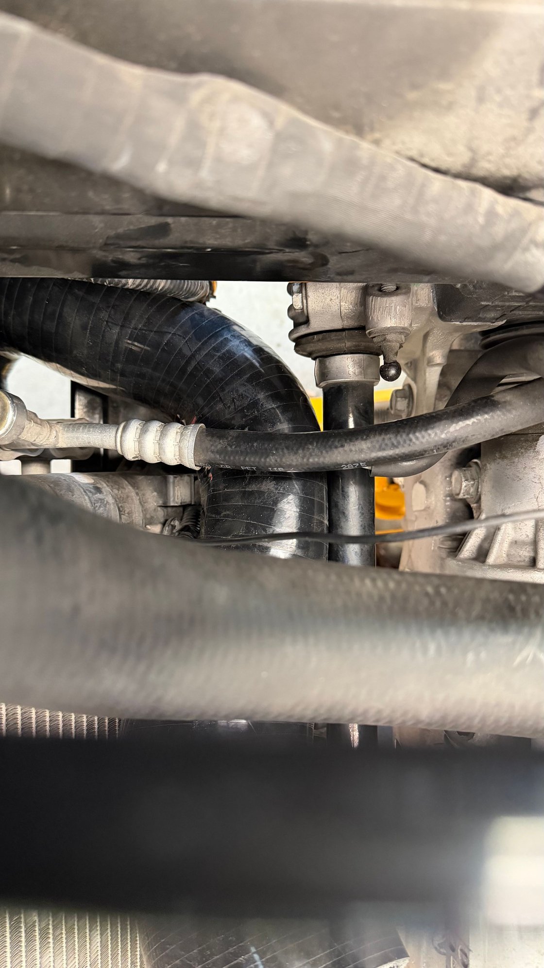

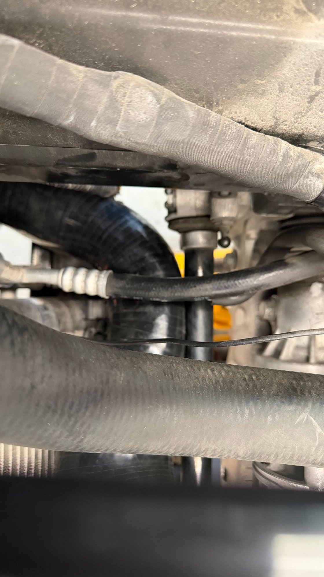

Am I an idiot or does the charge tube from the passenger side of the intercooler to the throttle body just not fit at all and smashes against everything? It’s against the sway bar, radiator hose, frame rail, wire harness, and a/c condenser lines. Am I just doing it wrong?

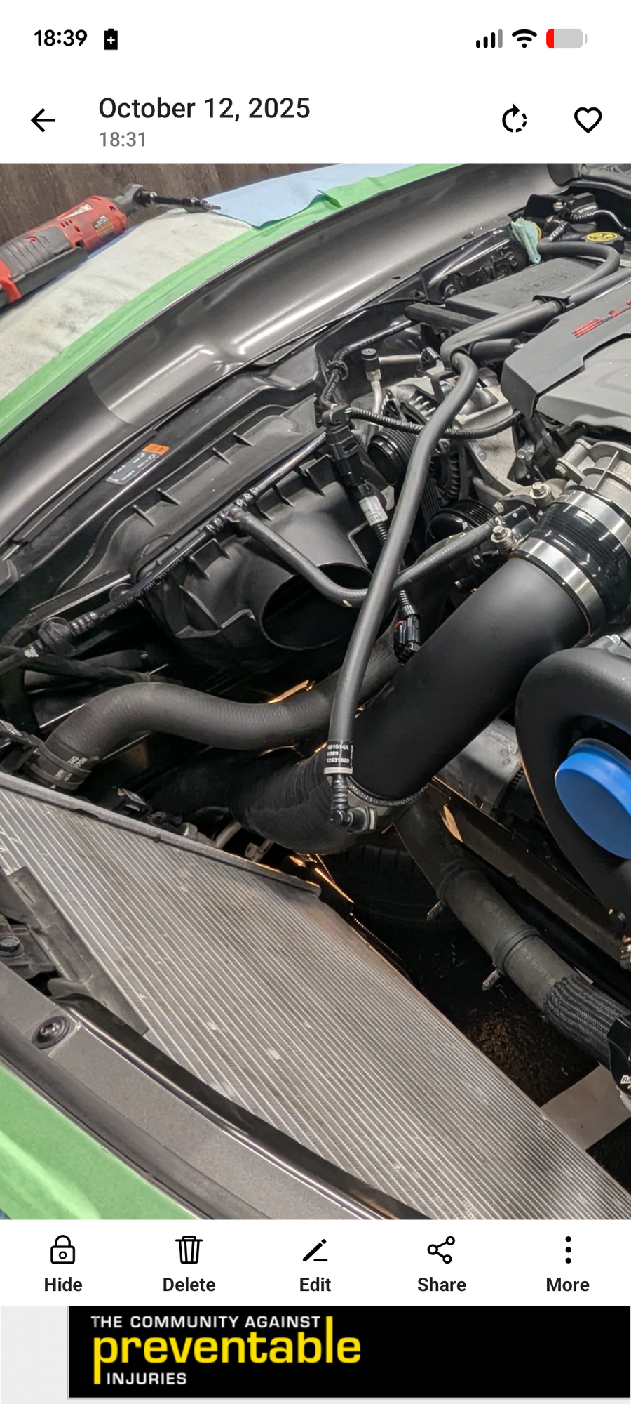

Put it over, not under
Your not alone, the aa install manual is one of the sloppiest manuals i have used/read
Photo attached
