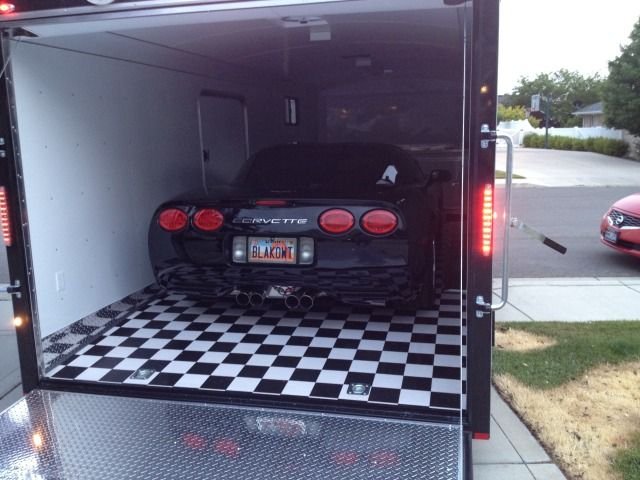

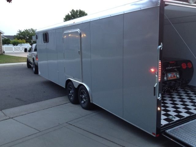

I have a 20' enclosed, and it's the absolute smallest enclosed I would recommend going with.
You can see mine in the pics below (the C7 fits exactly the same as the ZR1), and it's 16' 4" to where it starts to "V" down, and 20' 4" to the tip of the V, but the winch and battery take up almost 2' of that space. It still leaves a little bit of room for some lightweight track support stuff.
Like Snorman said, I find the "escape door" on the left a really great feature. I have a winch, but I can just open the door to easily get in or out of the car if I drive it in or out of the trailer.
In the second picture you might be able to make out a bar going across. Below that is a tire rack, and the bar goes through the hubs.
My trailer is aluminum and weighs 2500 lbs. With a 3500 lb car, 225 lbs of spare wheels/tires, and a 100 lbs or so of some track support junk, it's up around 6400 lbs or so. Loaded up it has a 725-750 lb tongue weight.
