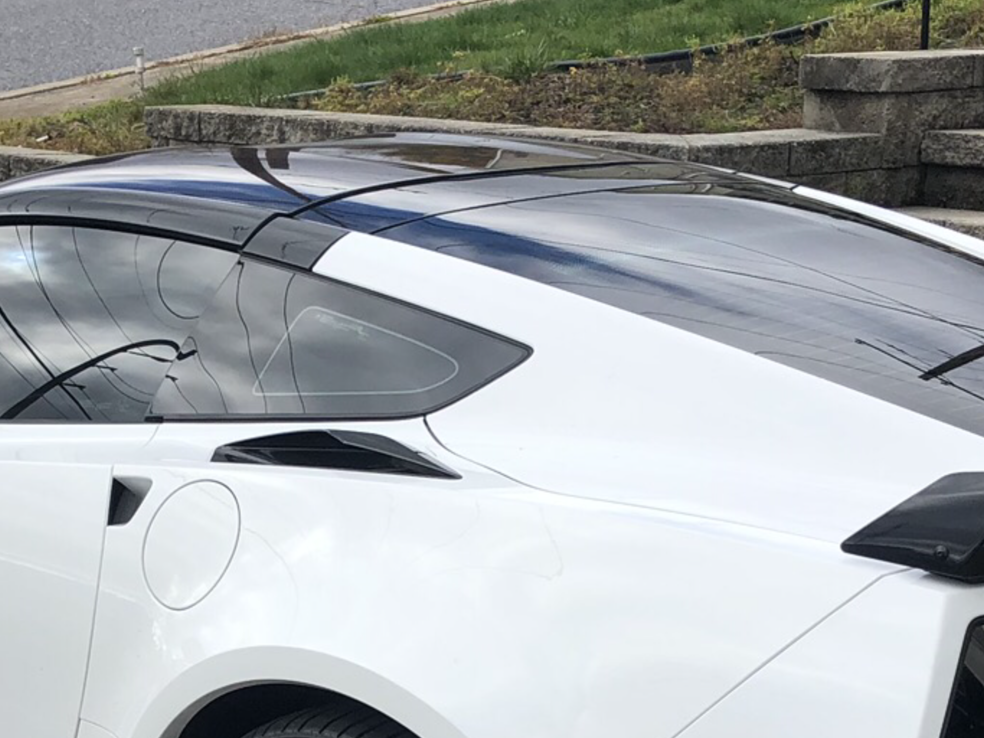

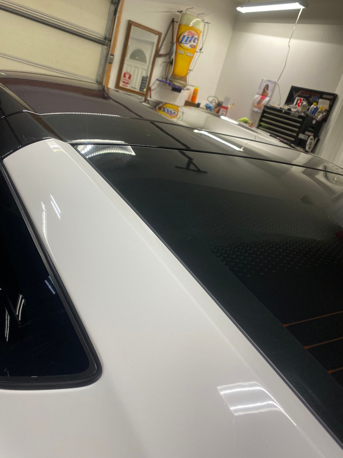

Thank you for the post.. I’ve been asking questions and looking at other corvettes to see if other roofs were not aligned. It lined up perfect after adjusting these bolts.. a before and after
Before
After
