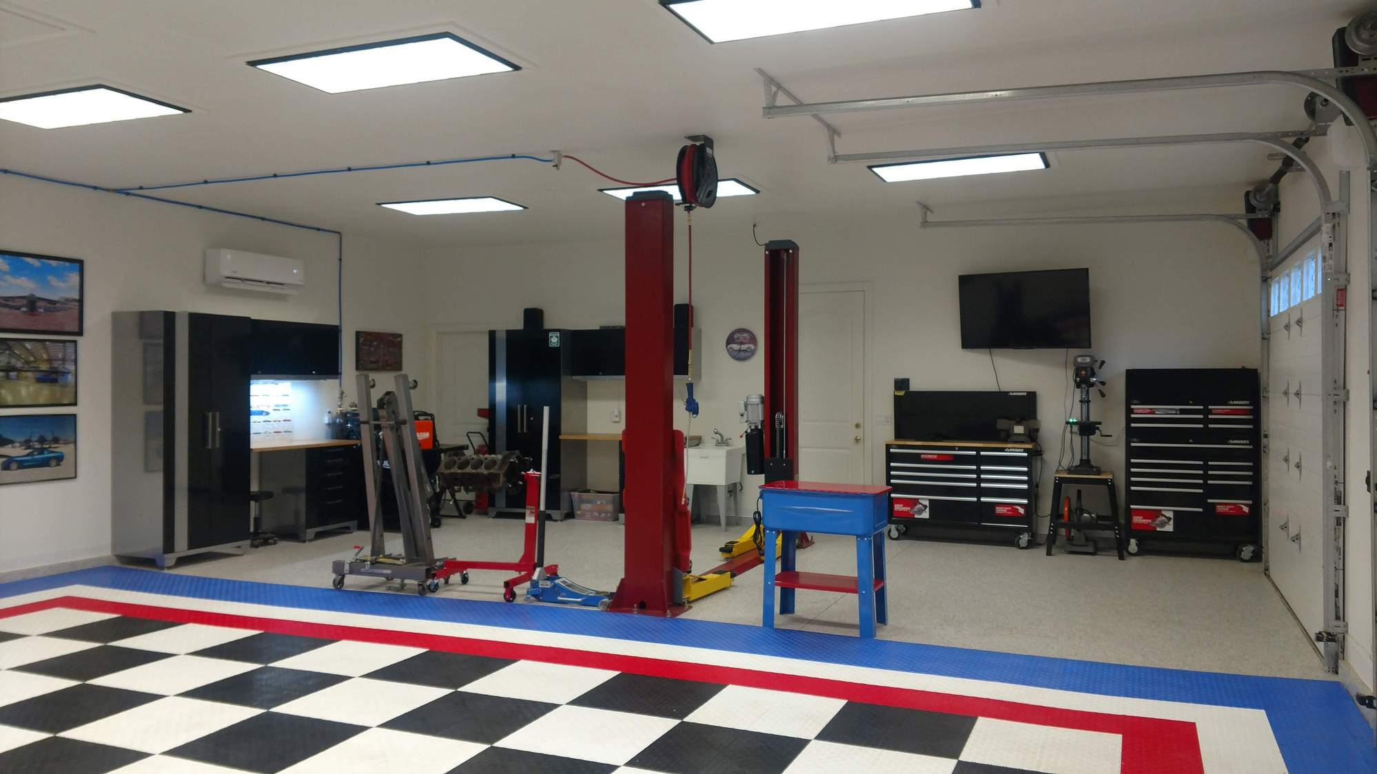

I finally got the inside done and took some pictures. I will organize and re-do the thread when I get a chance.

Awesome looking garage....major envy.

From the exterior photo it looks like it would be difficult to enter. What is the distance between the garage door and that retaining wall by the pool?
Great looking garage though. I am very envious and happy for you. Congratulations!

Nice project congrats
