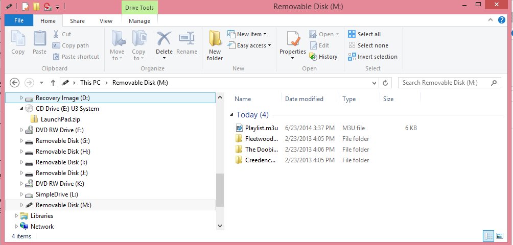

Anyway steps I took seem to be correct EXCEPT for one thing. When the file exported to the USB it placed the Playlist.m3u file on the bottom.
ford site said to make sure that file is at the top. Took me a few tries but finally got it to the top and I'll be darn if it didn't work. Going to try again and see I it really works or I just got lucky

Do a search for SD cards here in this forum and you'll find one with advice given by wormwood. That is the one I used and everything worked fine. As far as the m3u file that you need to bring over on the last step of his procedure. Once you close out your thumb drive and reopen it it usually goes right to the top at least that's what it's been doing for me since I've been redoing all my playlist over lately. The only thing I've noticed is that unless your songs are formatted and MP3 your album art will not appear on the display because the car will not except M4P formatting yet. So basically any songs I downloaded from iTunes had to be re-created.

Default Worked!
Ok it is time consuming but it looks like it works.
I got most of my information from CRAIGCURRY
First I reformatted my USB flash drive as it did have old files
Did a download of iTunes. Cranked up iTunes and let it finds all my albums, onec that was done I chose PLAYLIST an at bottom left corner hit the "+" sign and chose New Playlist. New screen shows up and I dis the drag and drop of 3 albums I wanted to try that had quite a few songs. One that was done I clicked the done button. Screen change a PLAYLIST is in the left pane. Right click Playlist and Export to USB drive and save as Playlist.m3u
Go to USB location and see Playlist.m3u. Here is where it gets tedious.
I did as CraigCurry explained: edit the m3u file in notepad and removed part of the path so that the mp3 files now have no path. They are accessed in the root directory where there are stored.
Example:
m3u file opened in notepad:
#EXTM3U
#EXTINF:232,Our Love - Al Jarreau
H:\Music\Al Jarreau\Breakin' Away\05 Our Love.mp3
Edit:
#EXTM3U
You need to do this for all the songs in the file
Once done resave the file. Then drag and drop the same albums to the USB drive making sure Playlist.m3u it the first file
Even worked in the wife's Malibu
