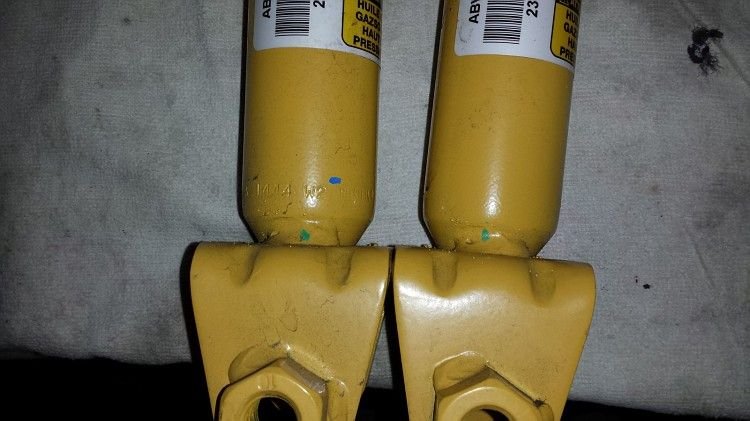

Mine is on the recall list. While changing tires side to side thought I would send pictures of mine. I haven't inspected welds for a long time but the terms hydrogen impregnation or lack of inert gas comes to mind, kind of a sputter weld.
The second which looks better has rust forming at the end of the weld where a small crack has appeared since painting.

Weld did not penetrate on that second shock.
Bad weld.

Both of your shock welds are a problem. One is cold, could be caused by grounding, etc., or as you said lack of shielding gas. The other issue of rust at the toe of the fillet reminds me of a comment I had after giving a technical talk, I’ll explain: The talk was on the “Welding of Race Cars” at an American Welding Society monthly meeting where I showed an old NASCAR crashed car in the Darlington museum I had taken photos of for a book I wrote published in 2012 by CarTech, entitled “Advanced Automotive Welding.” I mentioned there was rust on parts of the frame but not any of the welds, even bent frame welds were sound. This was in San Diego and a fellow who builds Baha race cars indicated they check for weld cracks after a race by washing the frame with water and leaving it wet. They identify weld cracks by rust spots a few days later on the light colored painted frame! Not scientific but an indicator! On fillet welds, they probably find toe cracks from high stresses and overloaded frame members. From your description the one weld sounds like it has a toe crack. Could be several causes.
The welds on my shocks are fine. Since my car was made in September 2013 and the welds are fine, the welding process was in control. It obviously was not when the welds on your shocks were made!
