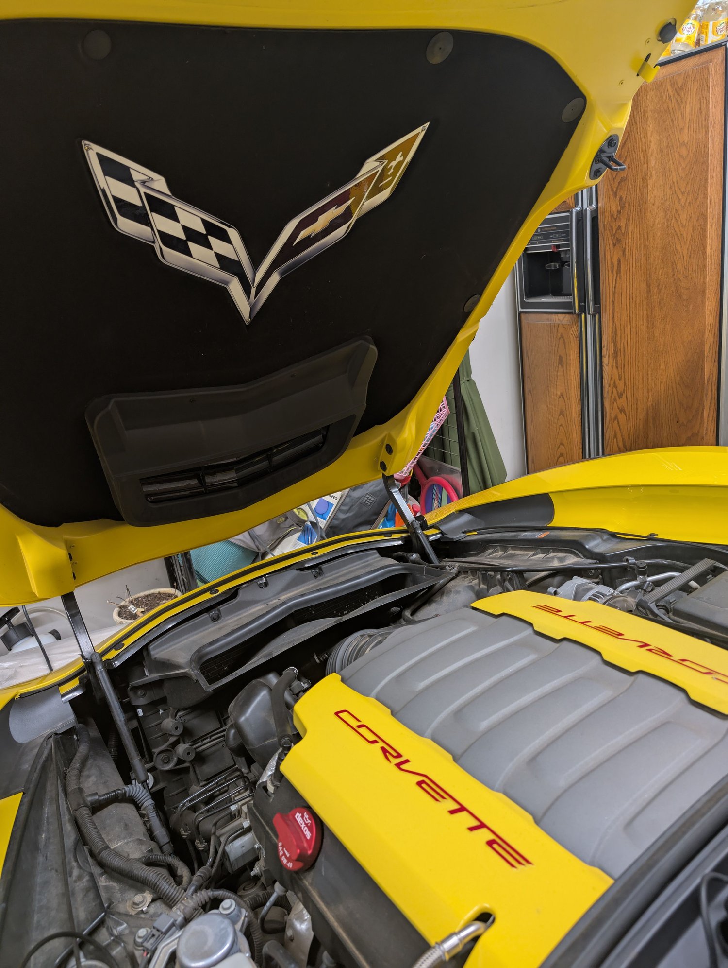

Originally Posted by cpages2
Anyone else have this problem?
Once a week or every other I try and pop the hood and wipe everything down to keep the dust/dirt down. Well I noticed that my red Corvette lettering on the Engine cover is flaking off very badly.
I can touch it with my hand and it comes off. Looks awful now
Wasnt sure if anyone else experienced this. Figured Dealer might put up a stink about replacing it, might be worth getting some vinly cut to put over the embossed letters.

My 2014 had the peeling issue. Out of warranty so I just removed the remaining paint with fingernail polish remover. Looks fine without the red letters.

I got a paint pen at Home Depot and repainted them.
I've had my covers replace once on my 2016, but the paint has peeled off already. Would you give me more info on the "paint pen" and how long since you painted the lettering - is it still okay?

My fix was to remove the failing letter paint, paint entire surface black, apply painters tape to lettering then repaint entire cover in red.

I painted mine to match my body color with this paint pen from Amazon:
https://www.amazon.com/gp/product/B0044D3SRG/ref=oh_aui_search_detailpage?ie=UTF8&psc=1 https://www.amazon.com/gp/product/B0044D3SRG/ref=oh_aui_search_detailpage?ie=UTF8&psc=1
I just took a gamble on the color and it turned out very close - not good enough certainly for touch up paint or anything like that, but fine for this application. It’s been approx 4 months since I did it and it still looks great.

I know this is an old thread but I opened up my hood for the first time and I seen the peeling. So I'm going to try to scratch it off and then paint it a dark blue I think that'll go nice with the steel metallic blue color of the car.

If you are talking about the fuel rail covers , I used these when I painted my covers white, really easy to apply.

I used the same ones. I went to an auto parts store and they mixed up a can of OEM color paint for my car.
