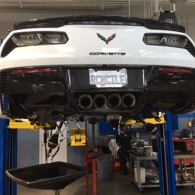

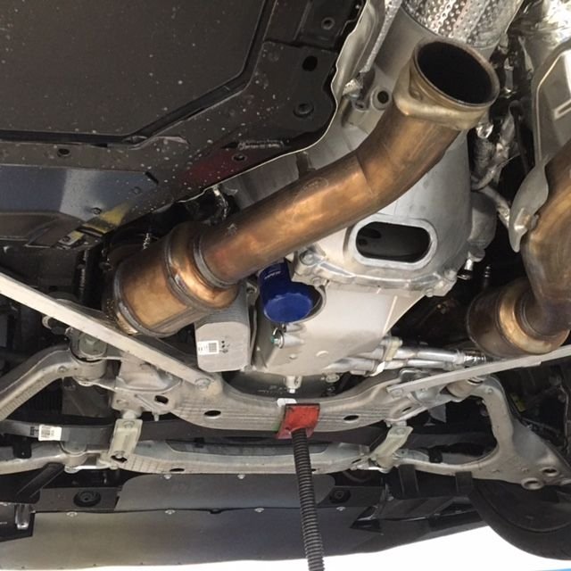

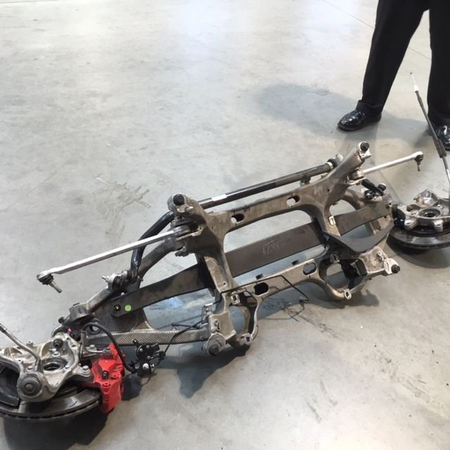

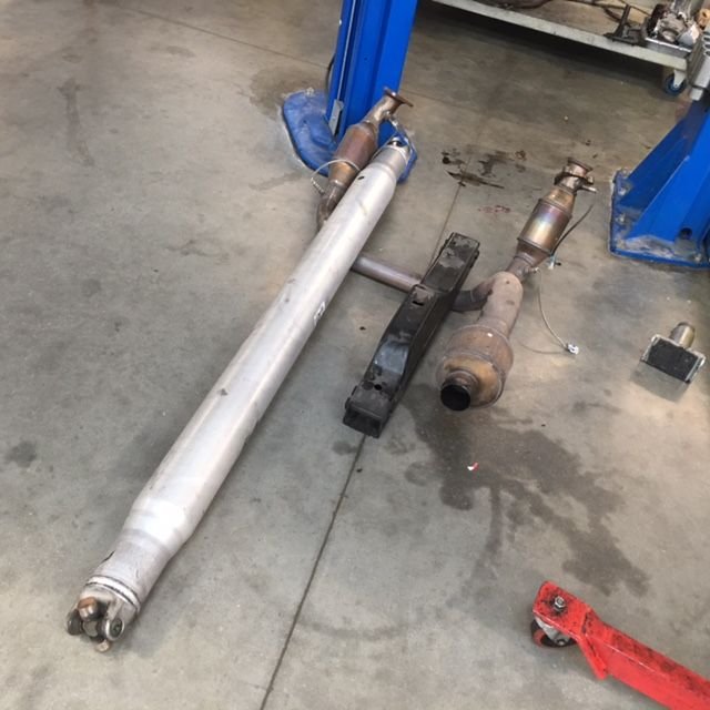

Yep. Mine has been in the shop for about nine days. In addition, the specialist for trans had a death in the family which delayed things. I'm hoping I'll get it back today. I have about 2,500 miles on it. I'm hoping the guys stays focused as he puts it all back together. I bought mine from Mike Furman in MD, shipped to So Cal, now at Premier Chev in Buena Park.

Those pics are scary Peter. I am sure I have a flex plate issue, rattle at idle in park or backing out of the garage centered under the car in that area, goes away after the car warms up substantially. Almost sounds like a valve rattle when the car is cold when accelerating but is gone once everything warms up. Appears that heat expands something to cause that rattle to go away, sure sounds like the flex plate issue. I have a lot of concern though seeing what has to be done to fix this, geez simple things get screwed up at these dealerships, this does not look simple. No dealership in my town has a Corvette certified technician.

it did take quite a bit to disassemble to get to the flexplate but it took about five days for that to happen. It appears that the original flex plates were assembled by rivets which would loosen overtime the replacement is a welded flexplate. Let's hope that does the trick. I took it on 1000 mile trip after it was fixed with no problems. Finding a specialized technician Will be important

That pic of the the drive shaft and y pipe were confusing me. Lol I'm like those are off a truck not a c7.
