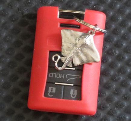

Had the same thought as I was ½ way thru! If you have 2 drivers this is an inexpensive solution and solves another problem, which is why I installed it. A forum poster commented they lost their key FOB (expensive) because it fell off of the detachable key that they had a ring attached. The same thing happened to me except mine was left in my jeans so wasn’t lost. Unlike my C6, which required a lot of force to press the key release the C7 FOB comes off too easily. This silicon rubber cover comes in many colors and retains the key. To remove it you have to remover the upper rubber ends. It's inexpensive. The Stingray on the key ring is not needed but neat! Just Google Corvette silicon key cover- lots of sources.

I have the same covers. Source usually found in the back of most car mags e.g. Road&Track. Also cushions the fob when I drop it on the concrete every now and then.
