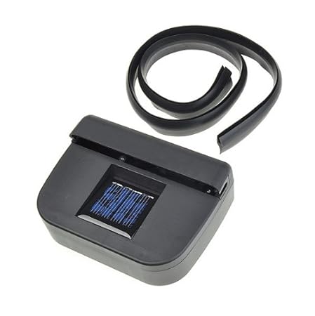

Don't want the extra weight. Buy yourself one of these:

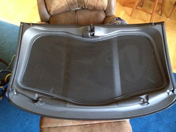

Default Homebrew sun shade
I had the clear top on my C6 with an aftermarket black plastic film. Worked ok.
I decided to make my own on the C7, since none was available when I got the car.
The material is sheet plastic that looks like carbon fiber with an adhesive back. Available on ebay for about $20. Comes in rolls and is easily cut to fit with a little trial and error. The roll is enough to make 2-3 top covers. The black strip is from home depot--window weatherstripping with adhesive back.
You need this because the plastic sheet will contract a little after installation, leaving a 1/8-1/4" gap.
I like the look and it is easily removable if need be. It is holding up well. Been on since January.
