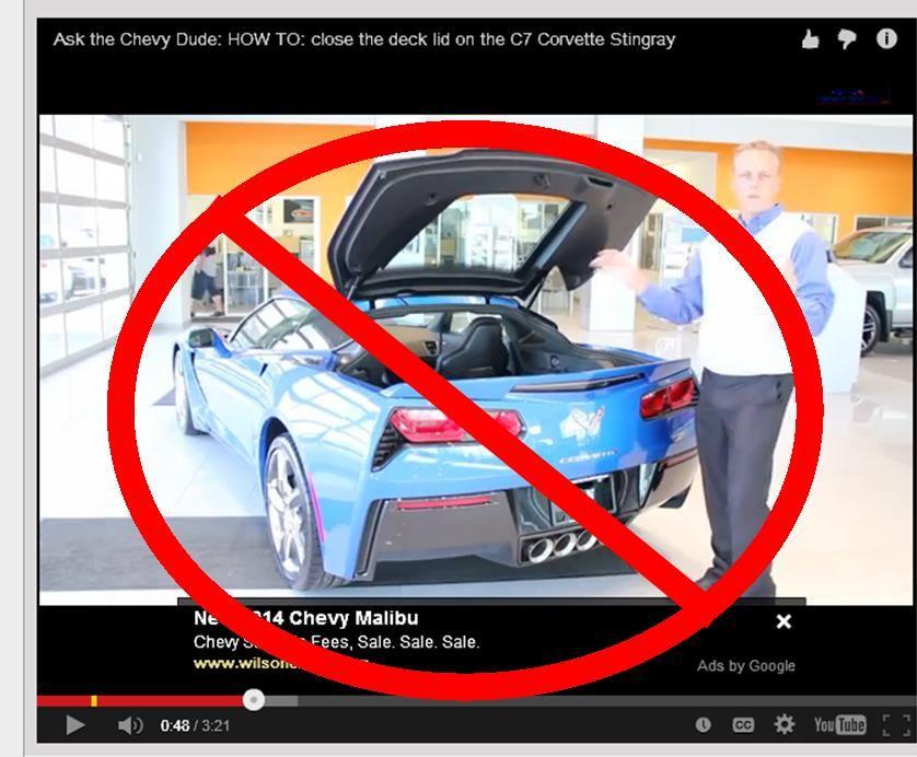

On both counts. Have had my C7 for a year, still need to have a door open and it closes with one finger. No matter how hard I slam the hatch, tried adjusting the hatch, memory activated vent opens etc, but it will not latch! Pressing on the center of the hatch frame causes paint cracking varified by many. Not a big deal but don't feel bad if what you see in the video, doesn't work! Some cars are just more air tight than others.
Works for Some C7's But Not All- in My Case After a Year Still Need the Door Open Before Closing-No Big Deal, Easy to Do!

Totally agree, and the memory wire technology is BS along with the video. Neither of them work! I just open a door/window and have quit getting frustrated-until I drive my C6...

I have checked and the memory wire activation of the vent works on my car but it’s just not big enough! You can watch it through the hole behind the license plate. Assume the test mules they tried in on just were not as air tight as some C7’s!
