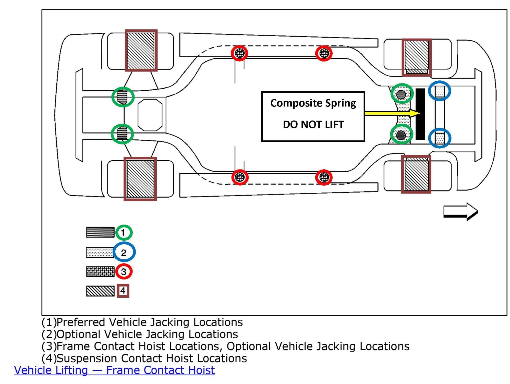

Originally Posted by silversmoke1957
I notice that some people use a jack to lift one side of the car and then lower the car onto a jackstand. Since the jack and jackstand cannot simultaneously use the same jacking point, where is the jackstand placed so that the car is safely supported and no damage done to the car underpinnings?
I use a two step process. I use 2 inch high 2 1/2 inch diameter jacking pucks ( to clear side skirts) and low profile jacks on both sides to raise car enough to get my large Jack with a cross brace under the front or rear proper cross member Jack points. Then depending what I am doing may put Jack stands under the jacking pads. Have also lifted the sides and put Jack stands under the front or rear cross member Jack points. Made this pic for post where they lifted on the front spring, hence the Caution do not lift! When changing oil I made some 6 inch high wood stands that fit under rear wheels and use Jack stands on the front jacking pads as mentioned above to get the car level. Don't like to use 4 Jack stands and get under the car.
Thanks for the great drawing. Helps remind me to stay away from the DO NOT LIFT area of the chassis. I agree with your thoughts about being uneasy crawling under the car when lifted with 4 jackstands. I'm more and more inclined to use some form of wheel cribs like your wood stands rather than jackstands if I am going to be under the car.
