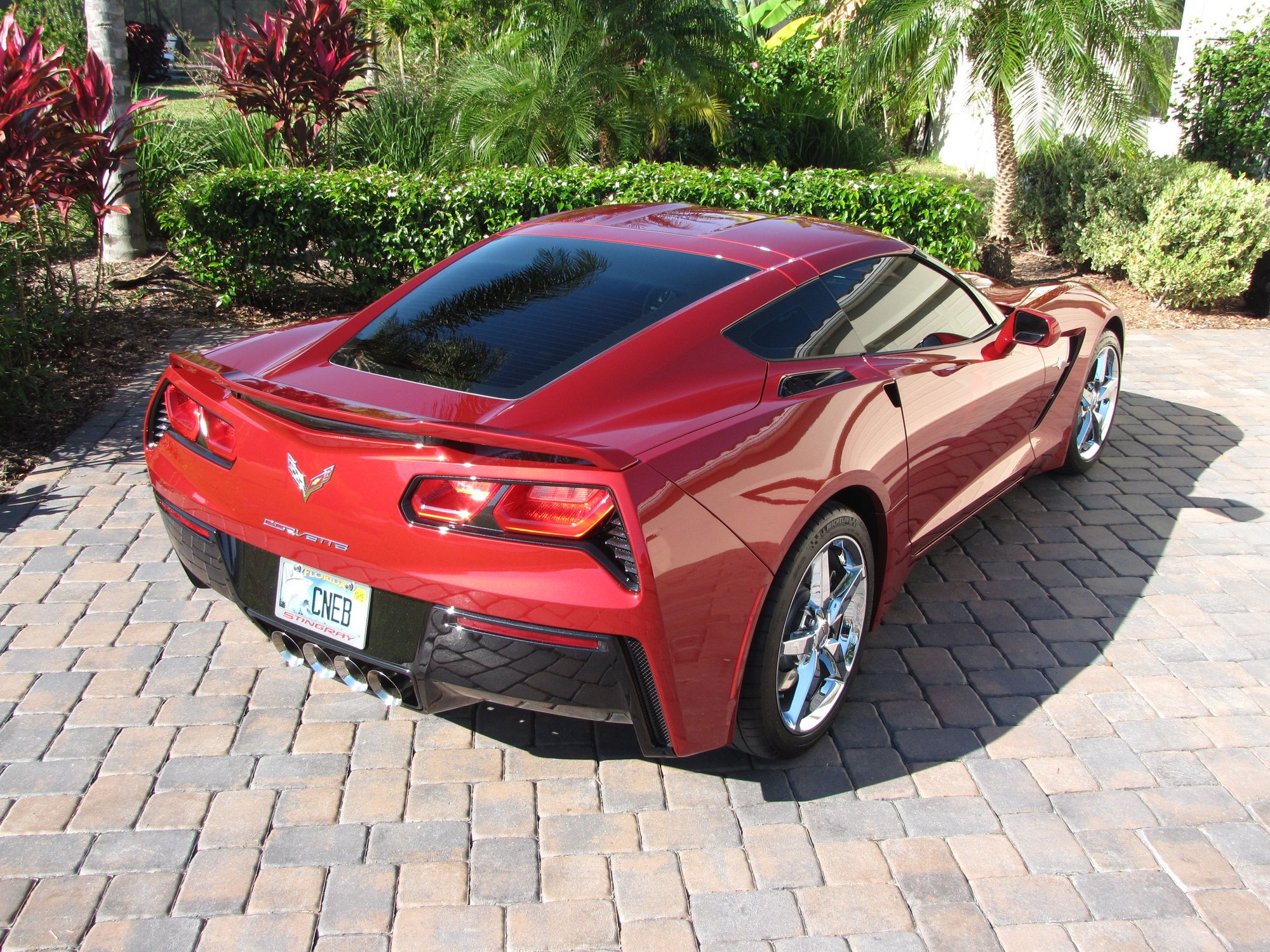

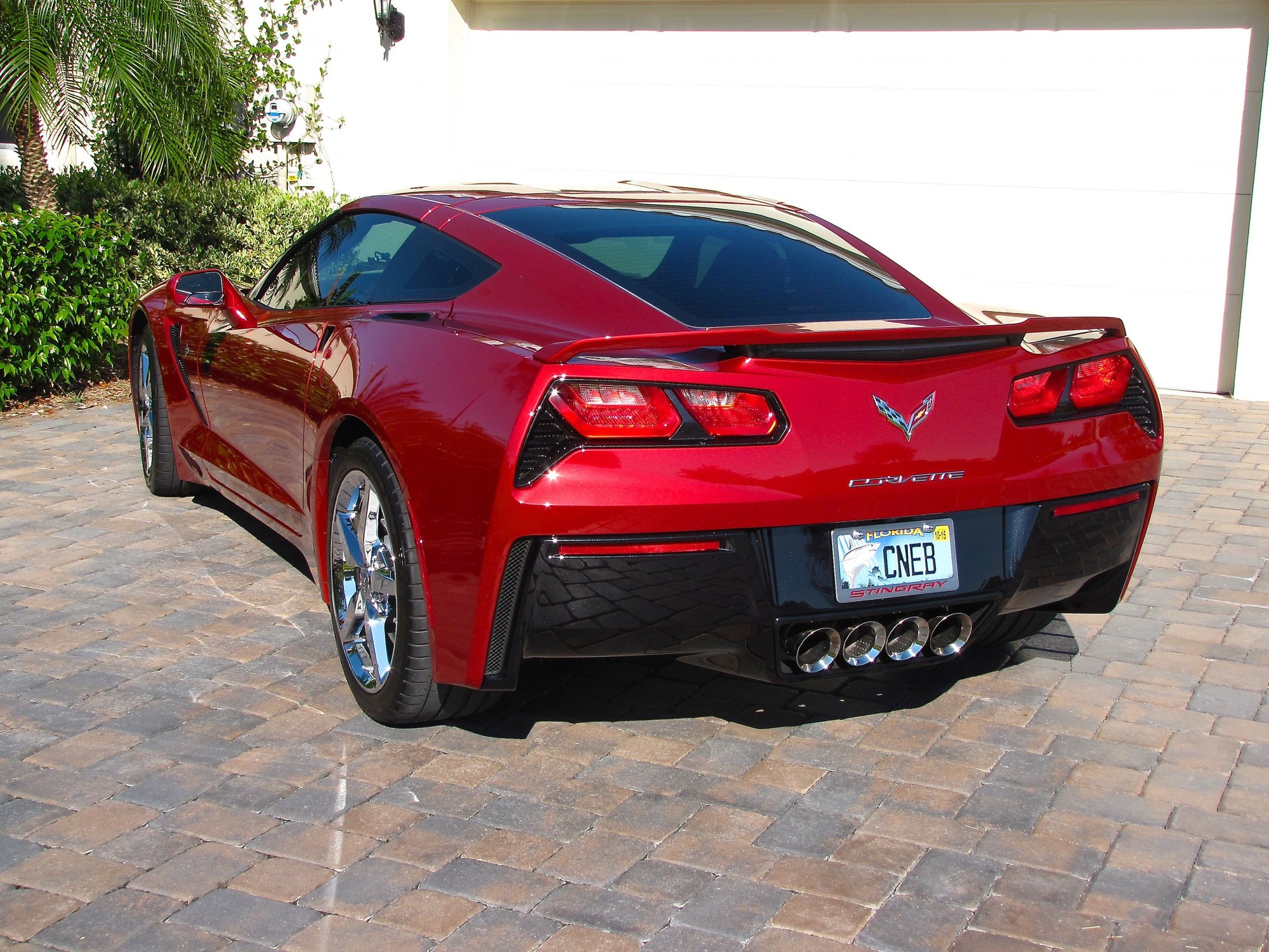

That spoiler looks good on your car, you don't see a lot of them. Do you have any other pictures of different angles showing the spoiler?

Thanks for posting the additional pictures. Your car looks great with that spoiler.
