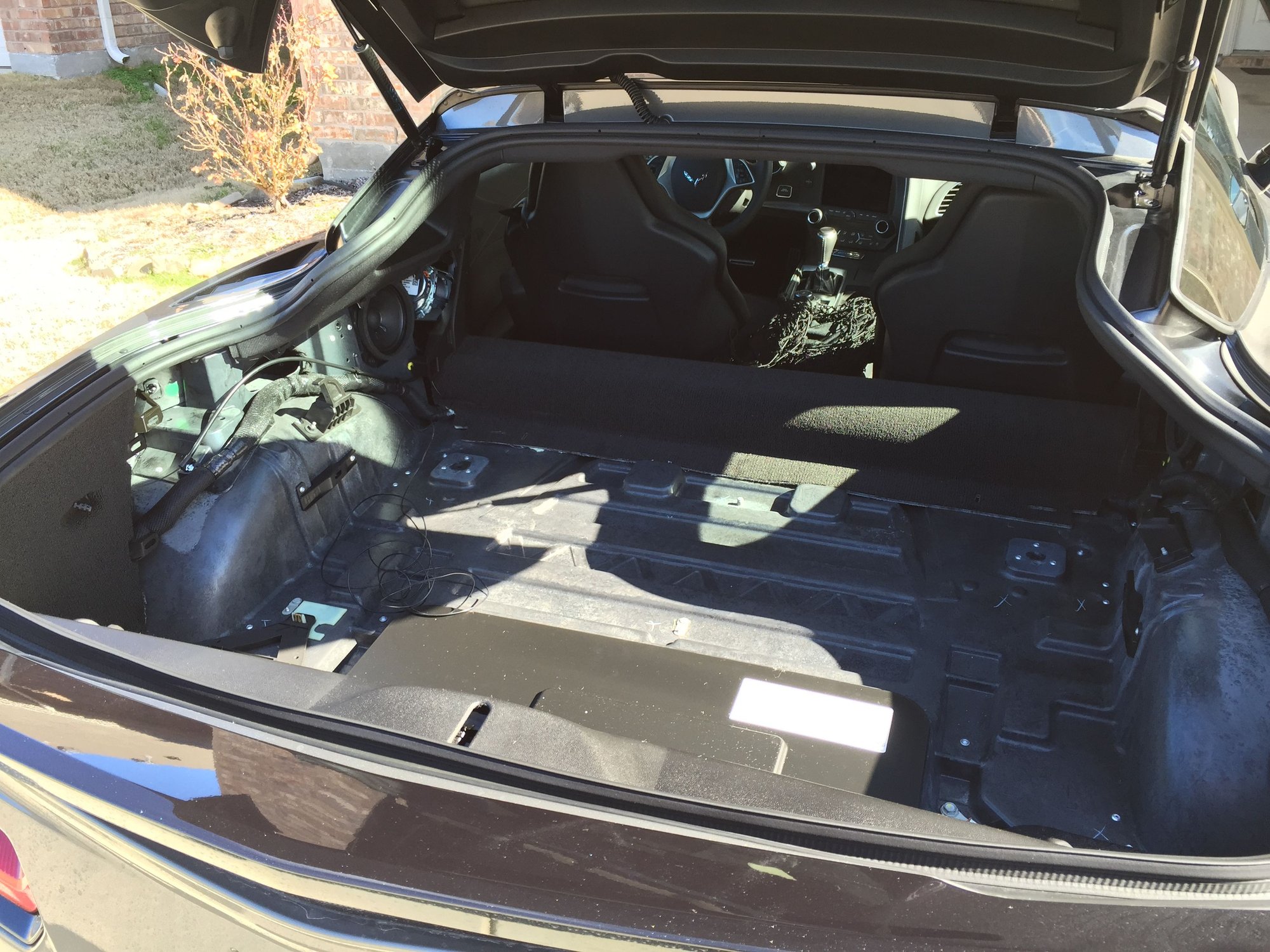

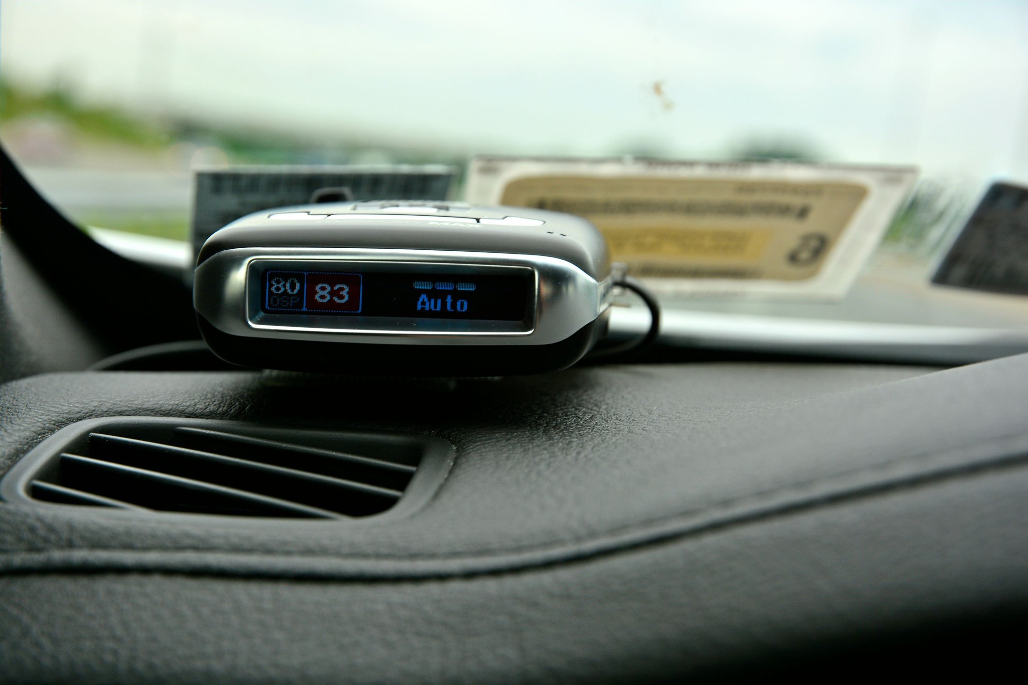

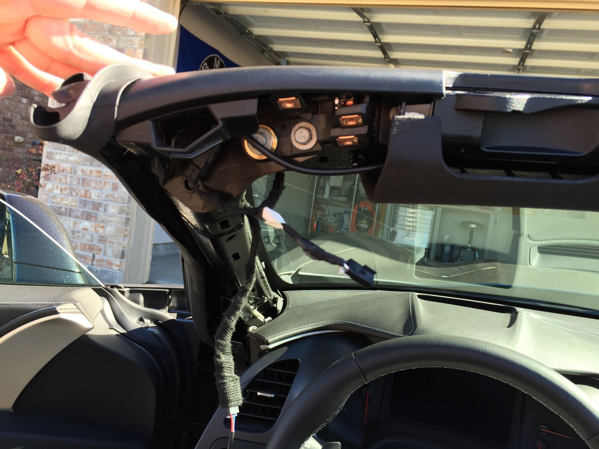

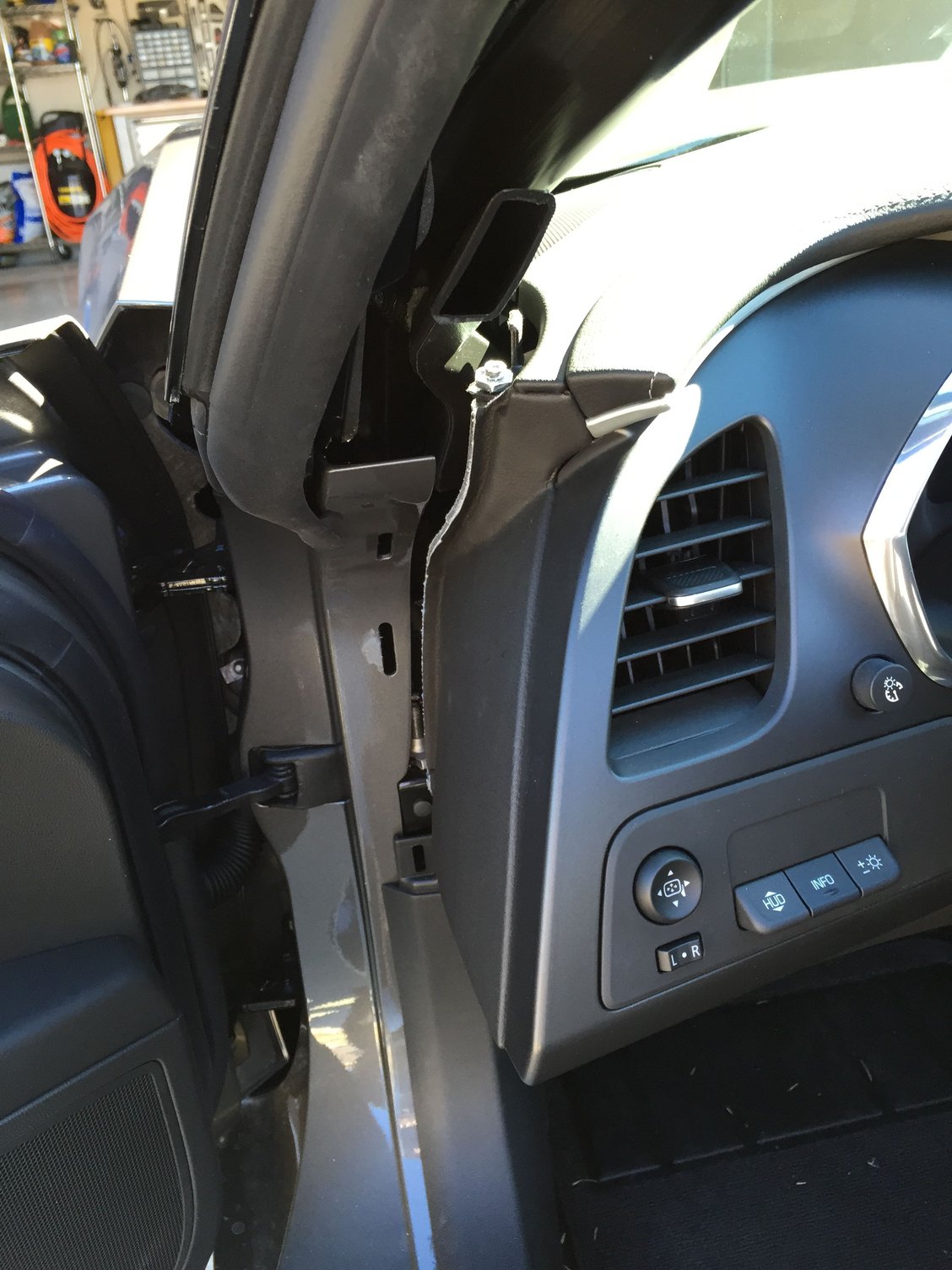

Installed. Took about two hours, but only because I was learning as I was going.

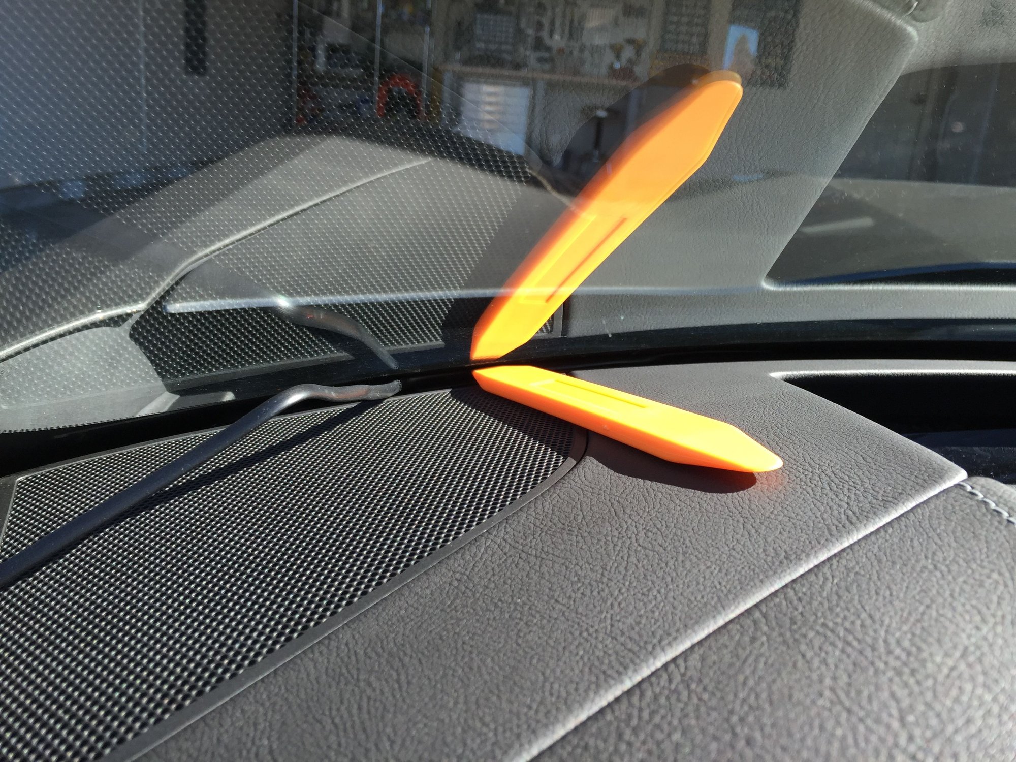

Remove the left side panel with a pry tool
Remove the a-pillar cover (there are threads on how to do this). You don't need to remove the center section where the mirror is, nor do you need to remove the mirror.
Tuck the wire between the dash and window. There is plenty of room to do this.

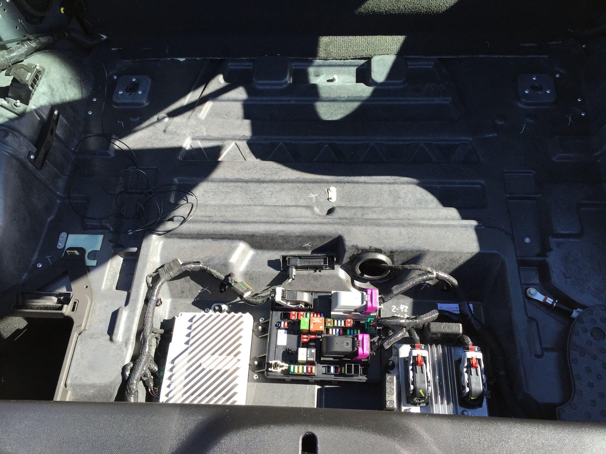

Run the wire along the left side of the dash. Having the a-pillar cover removed allows easy access. I ran the ground below the driver dash to an easily accessible bolt (obviously into metal).
Run the wire along the left side (sill). No need to remove this, just pull it up. You may be able to get to the rear fuse panel without removing the entire cargo mat, but it was pretty quick.
Tapped into fuse #37 with an add-a-fuse. I initially bought a full size add-a-fuse not realizing you need the mini version.
Used velcro under the radar detector (front and rear) to attach to the dash. It can be easily removed if taking your car into service, and doesn't show at all (if it's cut right)
Another view of the unit. Reception is great.

Seems to me that you have defeated your laser warning.
vs. an inch or two higher.

Laser is the thing I'm the least concerned about. If you're truly targeted with a laser gun, they've got your speed before you even hear the beep. There is very little scatter on lasers, but a small amount so if the car next to you gets hit, you might get a little warning. Radar, on the other hand, is far more prevalent and scatters nicely making it easy to pick up.
We'll see how it does, so far so good.

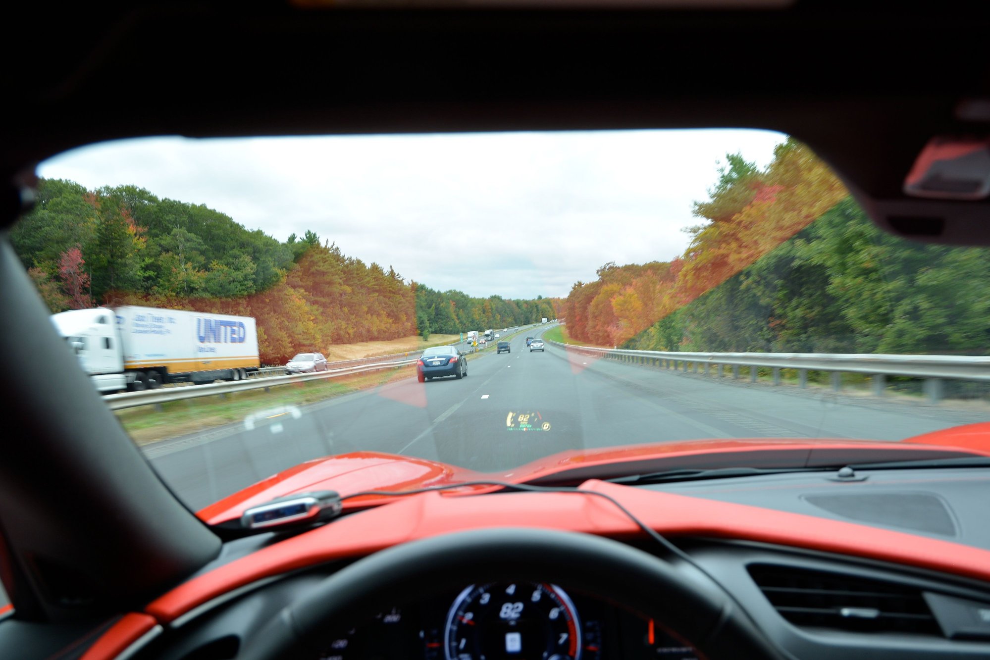

I keep mine in the same spot in all my cars.
This is the only pic I have of it in my C7 the day I picked it up so it's hot not wired in yet. Works fine in this location and is out of sight, even when I get pulled over it hard to see it.
I use the wire with a remote button, to silence unit, mounted on side of console just where it meets dash, close to my right knee. Sorry I have no pics since I have sold my C7 waiting for my Z.
With this install it's easy to move from car to car, I just have each car direct wired.
here it is mounted in my Lincoln MKS ( hard wired) I will take pic tomorrow showing the remote silence button to give you an idea where it is.

Alien, your's appears to be pointed into the hood? Nice install photo's!

I'm hoping the hood doesn't block too much of the signal. Preliminary tests look fine, but I'll need to give it a few more days to know for sure. I chose to run the wire along the left side so if the reception isn't good enough, I'll move the detector to the left of the center console (similar to above) and pull the excess wire tight. I actually thought ahead on this one.

I can confirm that I'm picking up radar signals without issue. The hood appears to have no (or negligible) affect on the range. I've got several areas where I get an X and K/Ka band false alert, and those are now being picked up at the same distance as before. Couldn't care less about the X, but the Ka band is important.
Obviously, the higher the detector the further it will receive a signal. I've never had an issue with dash mounted detectors, but my concern about the hood bulge appears to be unfounded. Now, as soon as I get a ticket because my detector didn't go off, I'll be editing this post.
