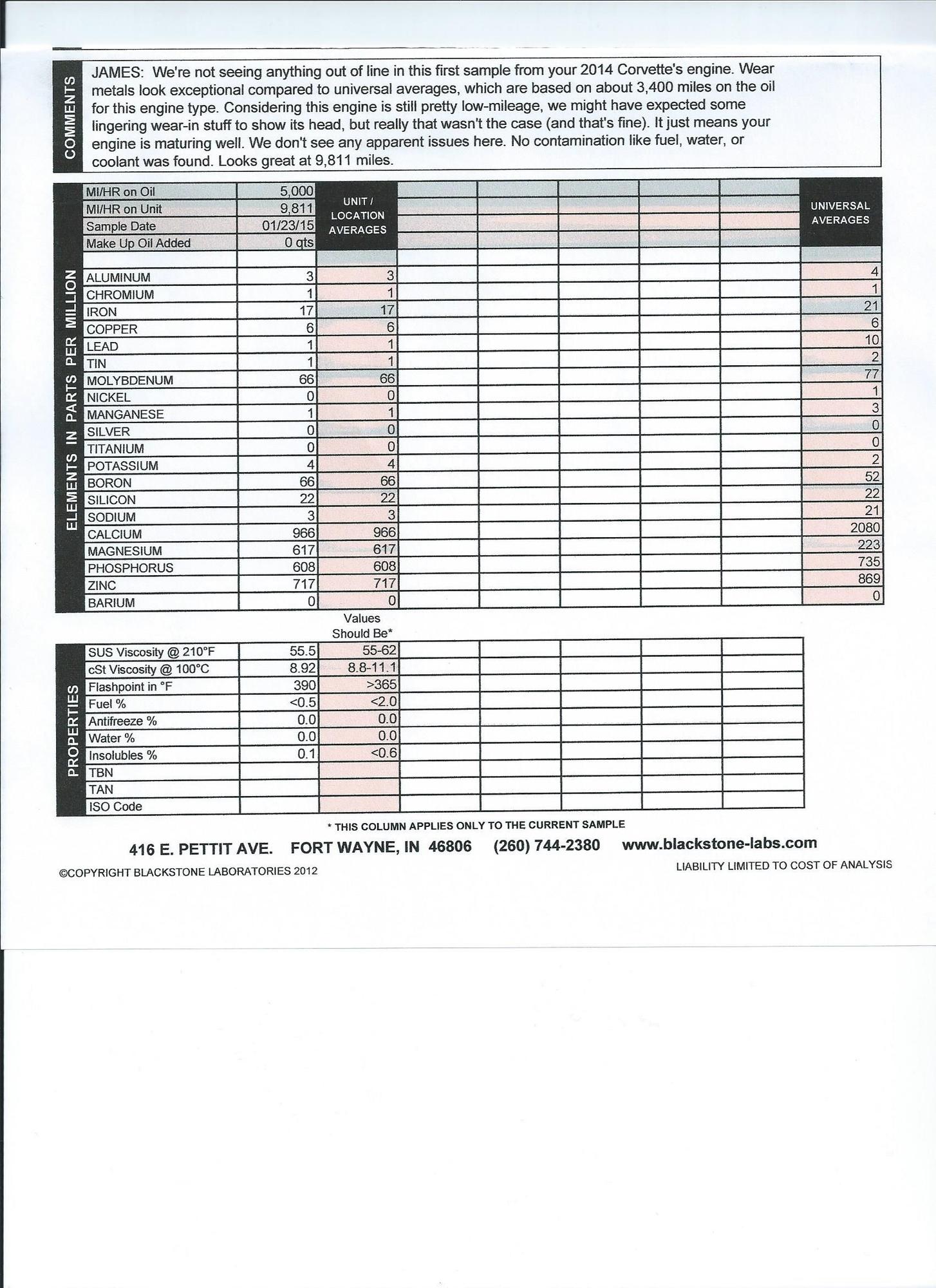

Here is a summary report of my Mobil 1 with about 5000 miles oil life indicator was at 41% Previous changes at 1000 and almost 5000 miles were not sampled. Car now has 9811 miles.
JAMES: We're not seeing anything out of line in this first sample from your 2014 Corvette's engine. Wear
metals look exceptional compared to universal averages, which are based on about 3,400 miles on the oil
for this engine type. Considering this engine is still pretty low-mileage, we might have expected some
lingering wear-in stuff to show its head, but really that wasn't the case (and that's fine). It just means your
engine is maturing well. We don't see any apparent issues here. No contamination like fuel, water, or
coolant was found. Looks great at 9,811 miles

Mind posting a pic of the analysis sheet? Blackstone? Glad to hear your engine is wearing in properly!

James,
Thanks for the information. It sounds like the few oil changes right at the
beginning worked wonders to get all that extra wear-in stuff out of the
engine. Also, since you noted it was a 6.2L engine, I've updated the report
just a little. We had the 5.7L engine recorded. I'll send an amended report
this afternoon, though the only thing it changes is the universal average
column (different engine, different averages). Your engine still looks
great by comparison, so the comments don't change much.
We'll look forward to that next sample!

Looks great!

Iron is a bit high for 5k, although that should probably come down as the engine breaks in a bit more. What really surprises me is the viscosity, it's now a 5w20, and Mobil 1 5w30 starts out around 11cst at 100c, so it dropped a lot more than it usually does. In my oil analysis reports it usually keeps it's viscosity right at 11cst, and rarely goes below 10cst in most reports I see. There doesn't seem to be any serious amount of fuel in the oil either, which would thin out the oil. That's something that worried me when I heard that GM was going with direct injection on the C7 as I know from other GM DI engines that they tend to how a lot of fuel dilution in the oil.

Thanks for comparable info, I will keep it in mind. In the mornings when I start the engine it seems to take a few seconds to hit on all eight like a cyl is loaded with fuel. So I too was interested about fuel dilution. Common in diesel engines when something is amiss! We used a vis-gage to check diesels quite often which compared two ball bearings sliding through glass tubes one with recent sample the other side fixed compare sample oil. When temp stabilized the ball bearings would travel the same unless sample oil was diluted then that side would fly down hill.
