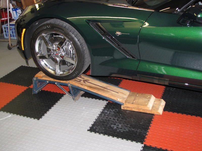

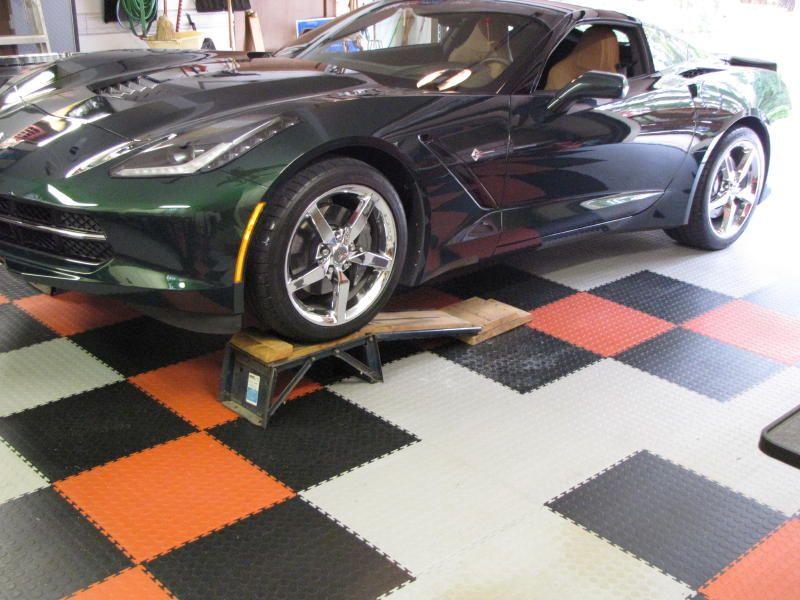

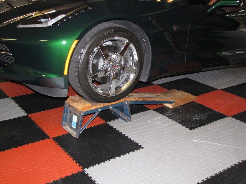

I don't know if these are available any more but I bought them 40 years ago from Montgomery Ward. That was prior to owning a Corvette. When I bought my C4, I added the wood boards, which worked fine. Don't laugh about the "Up" markings. The ends of he boards are beveled so they fit with no gaps. These now also work perfectly with my C7. They're made out of steel and the up ramp is removable once the car is on top in case you need additional space to roll your creeper under the side of the car.

I did a quick search and found ramps that are very similar to mine.
http://www.northerntool.com/shop/too...FVQ2gQodzhsAqw
