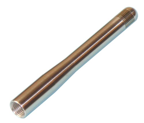

Got my two tools from Fred at Reverse Logic this afternoon.
Tried them out this evening. The tools are nicely finished and thread onto the rotor studs smoothly.
I found them to be very useful. Slid the tire/wheel onto the guide tools, then threaded nuts onto the remaining 3 studs, partially tightened them with a 4-legged spinner (probably not the correct name), then rotated the wheel 180 degrees to take the load off of the guide tools and they came off easily.
Nice tool, WELL worth the small price. Don
