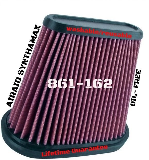

First, an aftermarket C7 intake is not going to hydrolock any easier than the stock one. S2000 ricer market intake stick the filter so low it might as well drag on the ground so naturally they suck water on the cars with geniuses behind the wheel that forgot they didn't buy a boat.
Second, the filter assembly is like 100x bigger than stock (at least double size) and can certainly flow more air through it. The Air Raid replacement filter is the same as stock, might flow a bit more like a K&N but not the same as replacing the box like an AFE or Halltech.
Third, on an otherwise bone stock car I would find large gains suspect. On a modified car the CAI will be of much more use.

Most filters that increase air flow (those that are washable/reusable), also allow more impurities to pass. The OEM filter does a superb job of filtering while allowing an adequate amount of air to flow so as not to affect the HP output adversely.
Can you gain a tich more HP by replacing the filter? Yep!
Can you get some more by increasing the size of the airbox? Yep!
Can you get some more with a huge air box and NO filter? You betcha!
Kinda depends what you're trying to achieve and at what cost/risk you're willing to take.

I humbly submit my personal testing... I got about half the advertised aFe gains, but aligned well with Halltech (which is likely 'true' gains). If all the items I tested, the aFe CAI was the biggest single item.
For the aFe CAI vs. stock CAI, see the "Run 1 vs. Run14" plot. This is also with the DRY filter. My testing showed showed zero difference at stock levels between the oiled and dry aFe filters.

My testing showed ZERO difference between the aFe oiled and dry filters at 'stock' power levels. The dry filter has same filtration as OEM, and the gains above were with dry filter.
