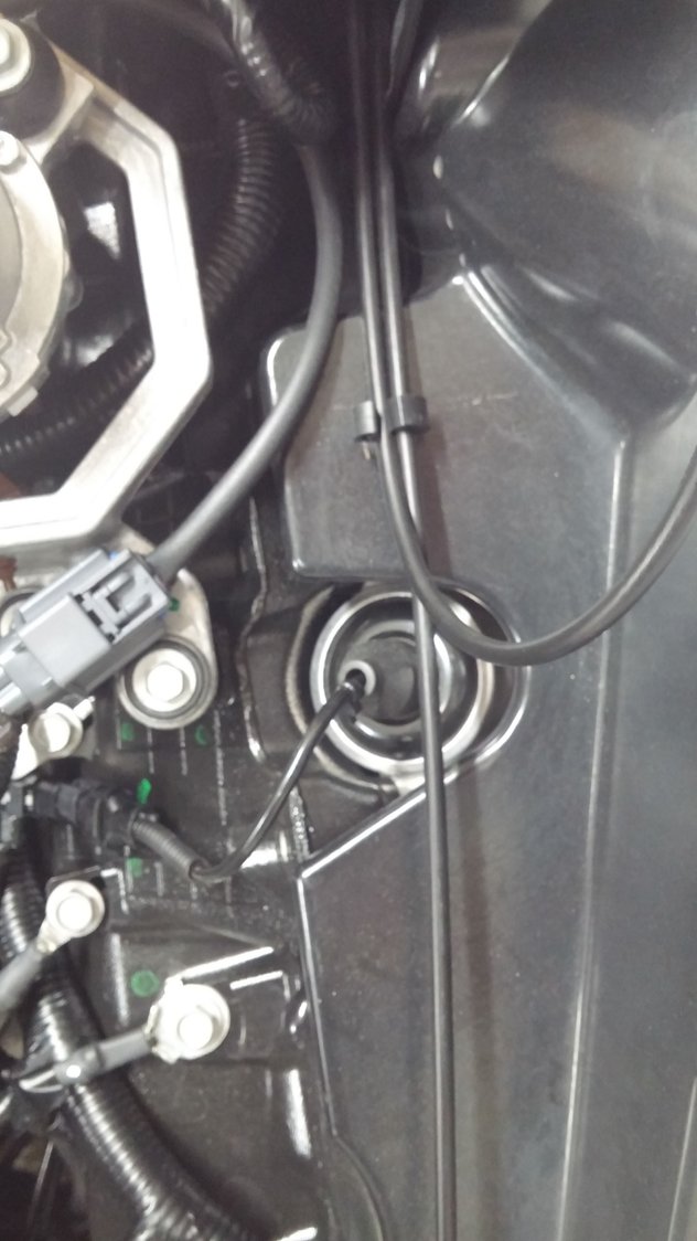

I know it sounds silly, but make sure the car was actually built with MSRC. Pop the hood and see if you have wires going into the top of the suspension. Orders and build sheets can say whatever they want, the proof is under the hood.
You mean like this??
Magnetic Ride??

You might want to check fuse #37 in the Engine Compartment Fuse Block. Fuse 37 is for "Real Time Damping". Same fuse on both 2014 and 2015.

Yes indeed!
