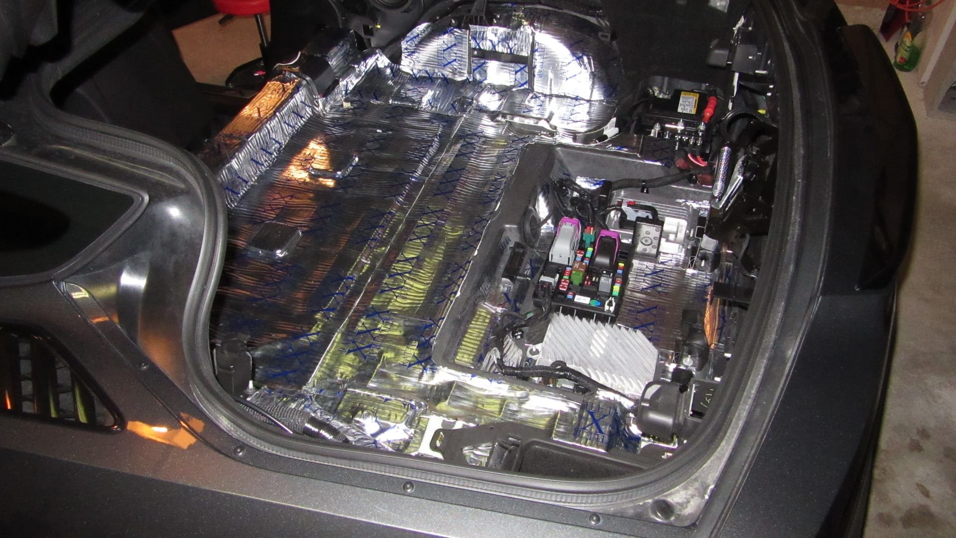

Since it was a Saturday, I decided to install Fatmat Sound Deadening (Rattel Trap Extreme) material. I ordered 100 sq ft from Amazon.com with a cost of $100.00. It was delivered mid week, so I thought today was a good day to install it. I own a 2015 C7 Coupe and found the interior cabin to be noisey. I wanted to reduce the noise from the tires.
I removed the side plastic panel that covers the wheel wells, removed the carpet and tie downs then went to work. It was determined that the hatch area flooring is all plastic, no metal floorborad, which I was quite surprised. I thought perhaps it might be a lightweight aluminum to match the chassis, but it wasn't. Also the covers to the wheel wells are also all plastic. How cheap can GM get!
I also pulled the one piece carpet panel that sits in back of the driver and passenger seat exposing the back panel. This panel was a thin metal. I did double thickness on the sound deadening material in back of the two seats.
It took about 6 hours total for the install and replacement of all side wheel well panels inside the hatch area, reinstall the hatch carpet, reinstall the cabin carpet in back of the seats. The hatch side panels (plastic) just snap out and back in with clips.
Here's a few photos of the install and the end result.
Ok......I test drove the C7 after I installed the sound deadening material Fatmat (Rattle Trap Extreme). Bought at Amazon.com. There was no elimination of the sweet exhaust sound from the NPP. It was great. Interior noise from wheel whine, and spin was reduced significantly as well as general road noise from the road surface. While I can't put a percentage on the noise reduction, it was very clear there was a major improvement. The audio system sounds great, and the interior cabin is much more comfortable from a noise standpoint, and conversation with any passenger will be easy to hear.
I have no regrets spending hours completing the project and highly recommend this modification to reduce overall road and tire noise within the C7. For the cost of $100 for 100 sq ft roll, it was worth every penny spent, and I even have some product left to complete a DIY project on my Jaguar XKR Portfolio Edition trunk area.

Once I pulled the rear hatch carpet it was easy to determine that the floorboard panel under the hatch carpet is a plastic material. I was quite surprised. However, the bulkhead in back of the seats appeared to be an aluminum or metal sheathing material. So, I double layered the Fatmat material in back of the seats.
The wheel wells that are exposed once the plastic covers are removed from inside the hatch are a plastic material as well. It is quite appearant that sound can be easily transmitted into the cabin of the C7, as GM has no insulation or sound proofing in that area of the wheel wells. The wheel wells and rear speakers are cleraly visable in my photos above as well as the plastic floorboard of the hatch area.

I am not sure I would call this a "Kit". However, it did come with a cutting knife and roller wheel to press down the backing of the sound deadening material. The product is sold by Fatmat, but the product is labeled as Rattle Trap Extreme. So you may be looking at the same material.
I also corrected the quanity I bought which was 50 sq ft, NOT 100 sq ft for a price of $109.00 from Amazon.
In some areas of the C7 cabin, like the bulkhead in back of the seats I used a double layer. I would think you may be able to get away buying the smaller roll of 25 sq ft. I have material leftover to complete the trunk area in my Jaguar XKR Portfolio Edition.

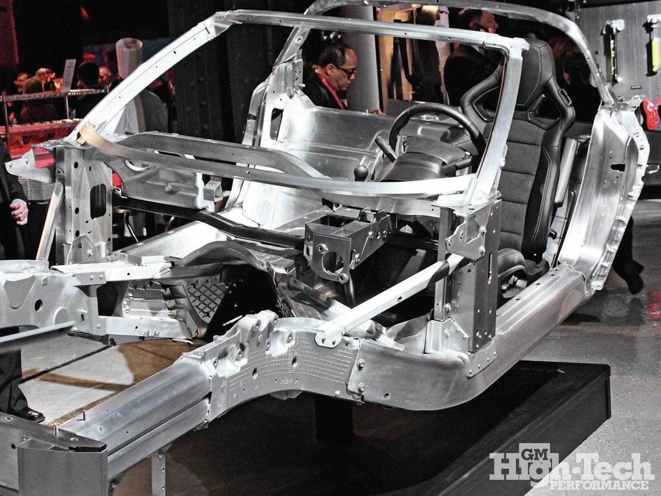

I’m a bit sensitive to the Vette materials since I worked in Ashtabula Ohio for 7 years where they made the 1953 Vette from fiberglass and according to GM, Morrison is still making the composite material panels. (I did not work in that field at all, I managed a welding R&D lab.) Had a technician who worked at the Morrison plant making the ‘53’s and when GM produced the cars themselves he made the prototypes for the ’55, and ’56 Vettes as I recall.
I believe the aluminum you're referring to is part of the chassis. It is a structural member and adds to the rigidity of the car. I’m in the welding business so aluminum and the new ultra high strength steels being used on cars are of a lot of interest. The Vette uses some 7000 series aluminum that is not weldable so they use rivets etc.! Granted they make the Vette with materials that function as needed at the least cost, thank goodness.
Believe the Porsche and Jaguar are more like unit body construction and the aluminum is probably structural. Recall seeing the all aluminum Jag chassis on display at a trade show and instead of welds they used mostly self piercing rivets and clinching.
Panels behind the seat are stuctural
Very neat welded, and riveted chassis.

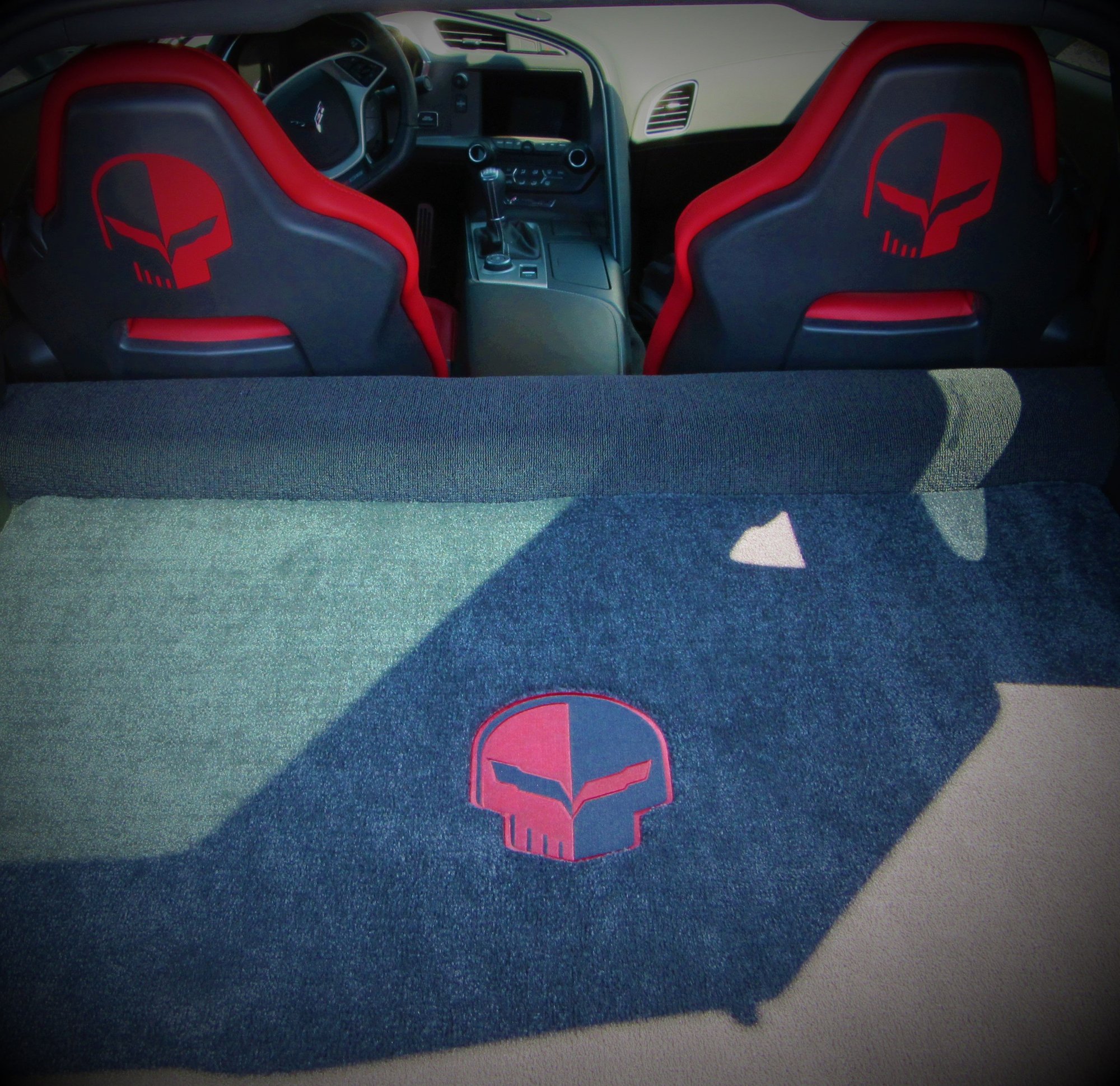

I have no regrets spending hours completing the project and highly recommend this modification to reduce overall road and tire noise within the C7. For the cost of $109 for 50 sq ft roll, it was worth every penny spent, and I even have some product left to complete a DIY project on my Jaguar XKR Portfolio Edition trunk area.
Question: Was it easy to get the carpet back in place in the hatch area and around the wheel well? A few folks in the past said it was difficult to get the carpet to lay back down in the back.
bevo_87:
Answer to your question......Yes, it is ultra easy to get the carpet back into the hatch area. The reason others had a rough time, is because they did not remove the side plastic panels that cover the wheel wells. As you will see in my photos above, I removed the plastic wheel well covers and I actually installed the sound deadening material over the wheel wells. If you don't remove the plastic side covers it would be very hard to replace and push the rear carpet back into place. The only effective way to remove the carpet and complete the job properly is too remove the side covers over the wheel wells and speakers.
If you don't remove the plastic side covers then noise from the wheel whine and spin will continue to enter the cabin area.
1) remove all the tie downs on the hatch carpet...takes a T30 Torx bit. Also remove the tie downs on the sides of the wheel wells. Remove the small plastic cargo net fasteners, just twist and remove.
2) remove the left and right plastic wheel well covers from the inside. (They are just clipped into place). They just pop out of the clips. There i a separate piece to eemove that has 2 clips on the top and 2 clips on the bottom which is the plastic piece that sits on the targo top holder when placing the target top in the hatch. They are easy to see on each side.
3) remove the rear hatch carpet..(it comes out in one piece). The tiny door in the carpet (left side rear chubby) also has clips to hold it in place. Gently put your fingers under the plastic rim and pull up.
4) remove carpet cover that sits inback of the seats.
5) Install Fatmat (Rattle Trap Extreme)...double layer suggested in back of the seats on the aluminum bulkhead. Double layer suggested over the wheel wells.
6) replace carpet that goes in back of the seats 1st.
7) replace the rear hatch carpet 2nd.
8) Reinstall the plastic wheel/speaker covers, they just snap back in place.
9) reinstall the carpet hatch tie downs.
10) take the C7 for a ride and notice the significant difference in noise level then turn on the audio system and enjoy the new sound.
In order to make this project effective, you need to remove the wheel well/spealer side panels.
Don't be afraid of the side panels. Just slip your fingers under the bottom to start and pull the panels out. The clips will release, then you can work around the sides and the top of the plastic panel.
Email or ask if you have any other questions. I am a proven testimonial that this project can be done as a DIY project. Takes about 6 hours with a few breaks to rest your back from bending over.
Here's a photo of where the clips are attached to hold the plastic panel in place.
