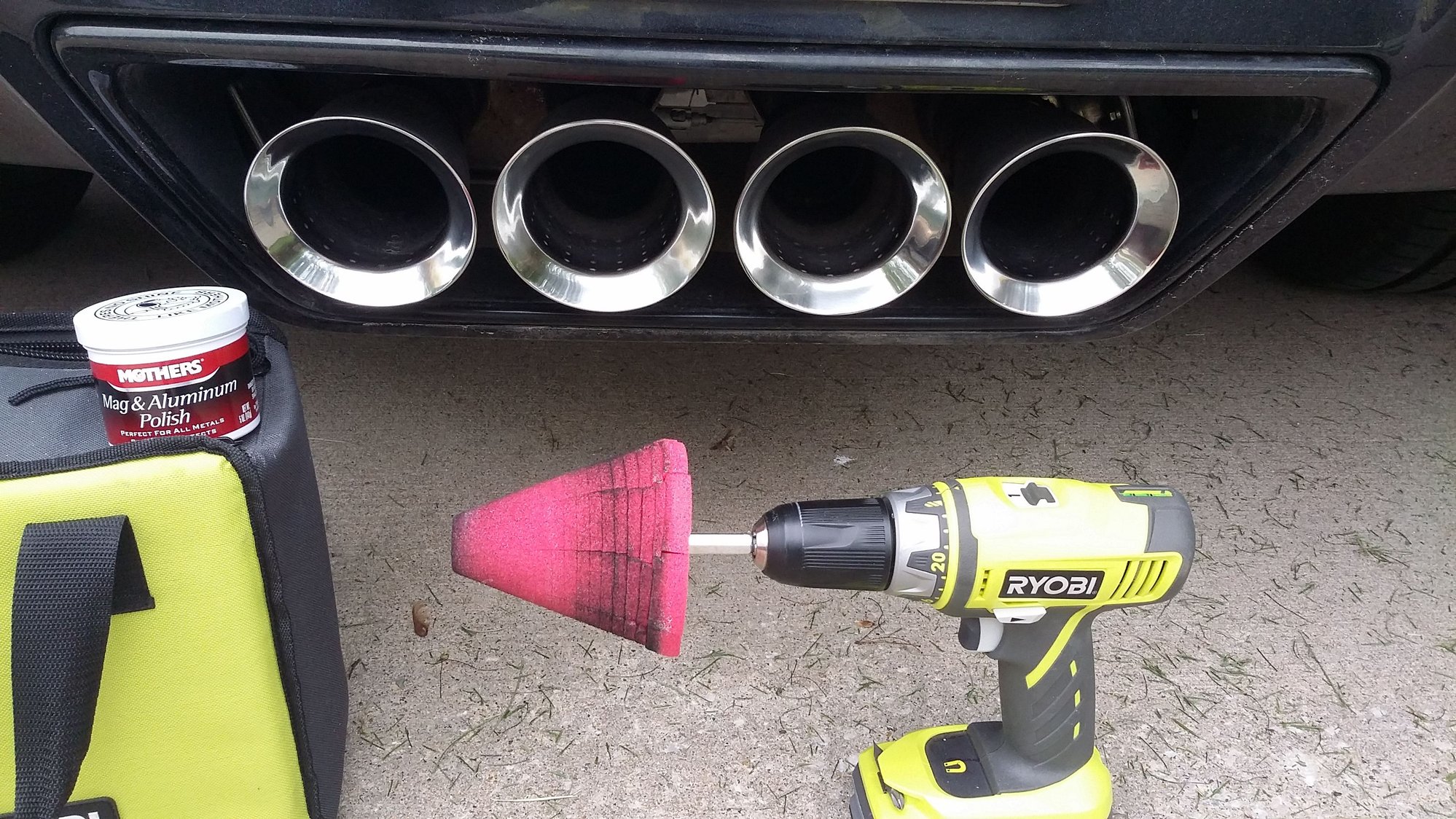

I pulled the fuse for the NPP so the flaps are always open - It sounds great, but the outside trumpets get pretty dirty very quickly even on short drives. I just use a damp paper towel followed by a dry one to clean them up. Every couple weeks when I do a touch-up wax I use the cone tool to clean all the crap out of the perforated inner pipes. A bit on the **** side maybe, but it really bugs me when they a black and sooty.
Where does one get a "cone tool?"
Most any auto parts store, or Amazon.
