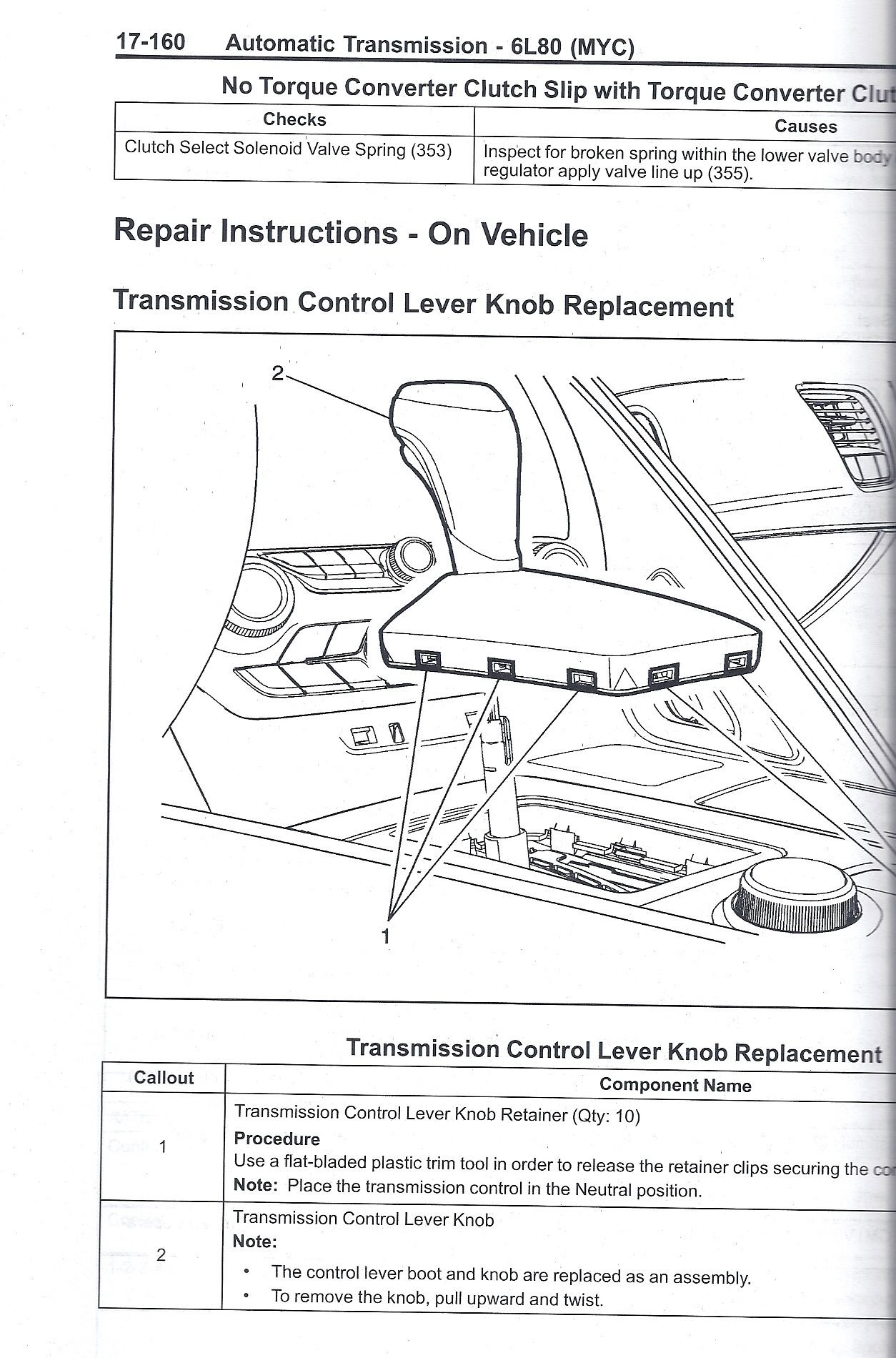

Assuming you have a manual... (I don't have an auto therefore can't confirm)
You have to do it from the back side of the console. To do so, remove the console and the sifter **** (in either order, but I would do the **** first)
Note - on the shift **** collar; to remove you must apply a fair amount of upward pressure and while doing so, twist it in a counterclockwise direction. It should go about a quarter of a turn and drop down. You'll see the plastic pin and track it is on after removal and understand the upward pressure once you see it.
There is a torx (T15?) screw on the driver's side of the ****. After you drop the collar it will be exposed. Unscrew that and the **** will slide right off.
Once you have the console completely off, flip it over and start with a trim tool at what would be the side closest to the front of the car and work your way around. I found the clips love to reengage once you move to the next one (what a PITA, but its probably a good thing), so I used tooth picks (or popsicle sticks even) to hold the clips out while I worked on the next. Work it all the way around and it should just pop out IIRC. To install into the new console just pop it in and reverse the steps.

If you have trouble getting the chrome ring to pull down (actually it requires pulling up before pushing down (sounds like a John Kerry's run for President!) this PDF will help. A number of us have been frustrated since "some cars" make turning it CCW to release very difficult. One fellow said he was ready to use C4 explosive! The pics in this PDF show why. Took me some time after I saw a video showing it done in 10 seconds! Mine wasn't so simple! http://netwelding.com/Shift_Knob.pdf
