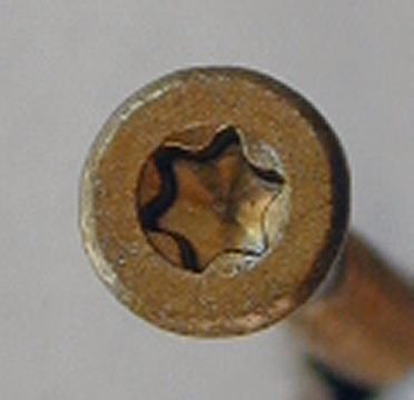

Can't tell you exactly since you provided no pic but most screws in the C7 are Torx. Here's a pic see if it looks like this:
Most Screws in C7 are Torx. If small size, be sure to use a quality screw driver or bit.
