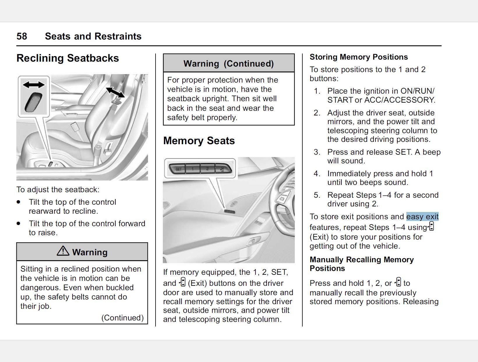

There is a place in the settings menu for "auto easy exit" or something like that. That may be what your talking about. Saw it the other day but havent played with it yet.
Old Aug 2, 2015 | 10:45 PM
16LBCOUPE's Avatar
16LBCOUPE
Posts: 67
Default automatic seat question
Got this from another forum....
That is an option controlled under Settings. See pg 5-44 of Manual. Apparently the choices are based on whether you have auto or manual trans. In my manual trans, if I set auto "on" it re-positions the seat when door opens (in an auto trans, apparently it does it when you turn ignition on). If you turn auto memory "off" you set seat by pushing and holding memory button.

found it. Sure enough the menu for that only shows up when the vehicle is actually running

Best: Tutorial by "That Cute Ginger." She covers steps not included in the owner's manual. When I followed her directions, it all worked.

The option for door open or start button is eliminated in the 2016 (2:17 in the video).
Make sure you are programing the the 1 or 2 buttons which correspond the the FOB you are using. The DIC will tell you if the FOB you have is memory 1 or 2.
