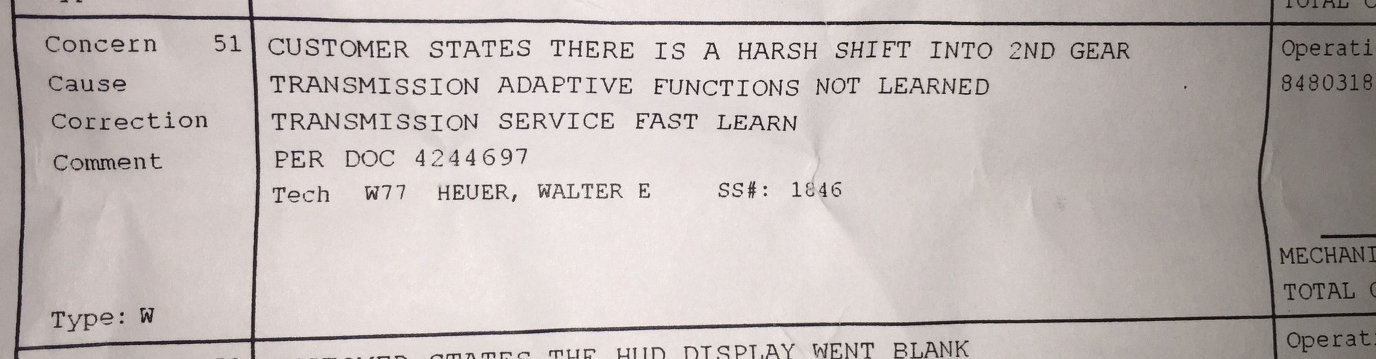

Default Corrective Actions So Far
8 Speed Hard Second Shifting Correction:
HUD and DIC Blackout Correction:
Solution to NRB Orange Peel still under evaluation:
