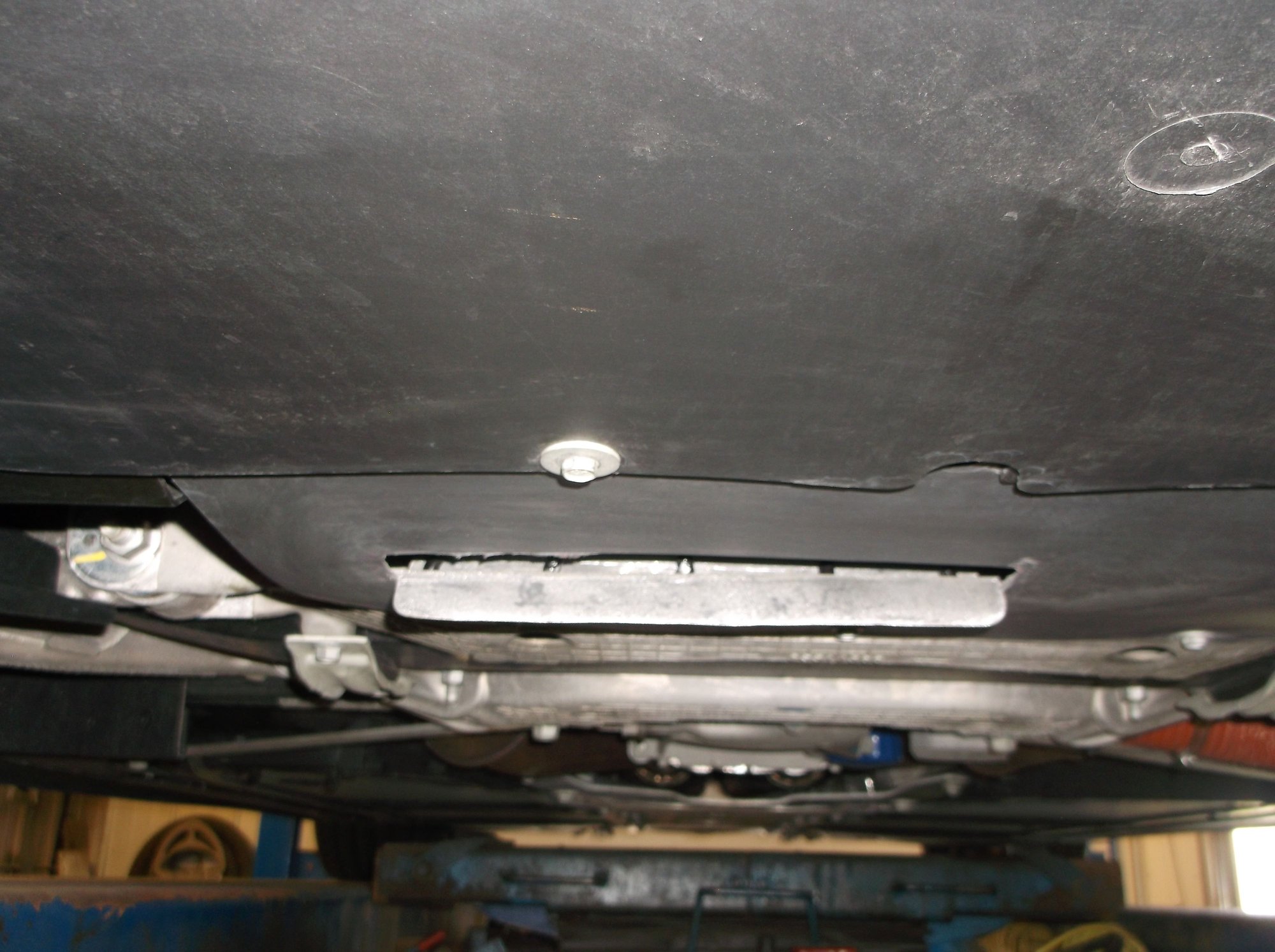

This is what we did to hopefully take care of the steering issue. Its been done before by someone else on here. This opening will force fresh air from under the car directly onto the electric actuator.
