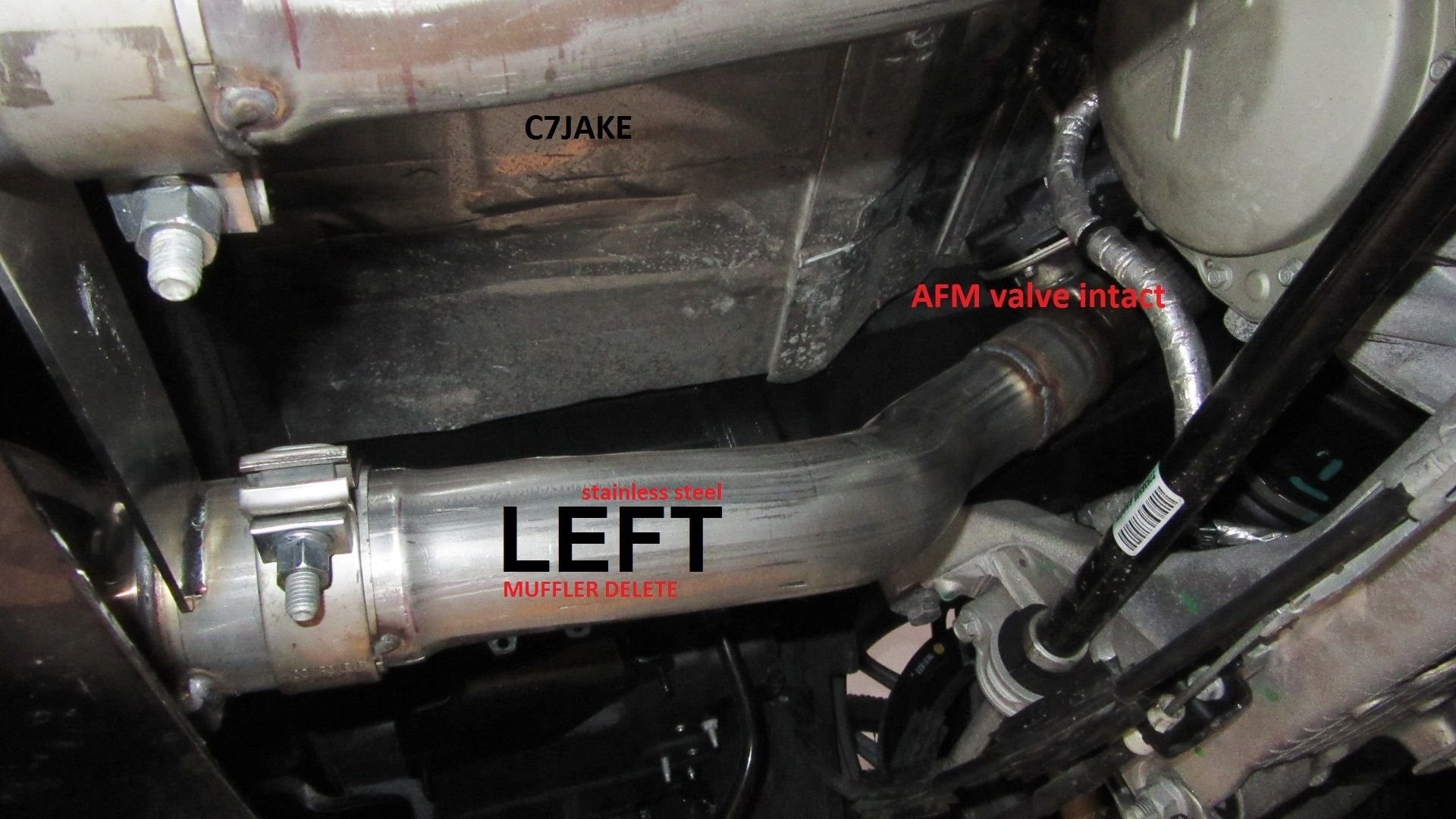

Competent shop can complete the job in 2 hrs.
No need to remove rear fascia.

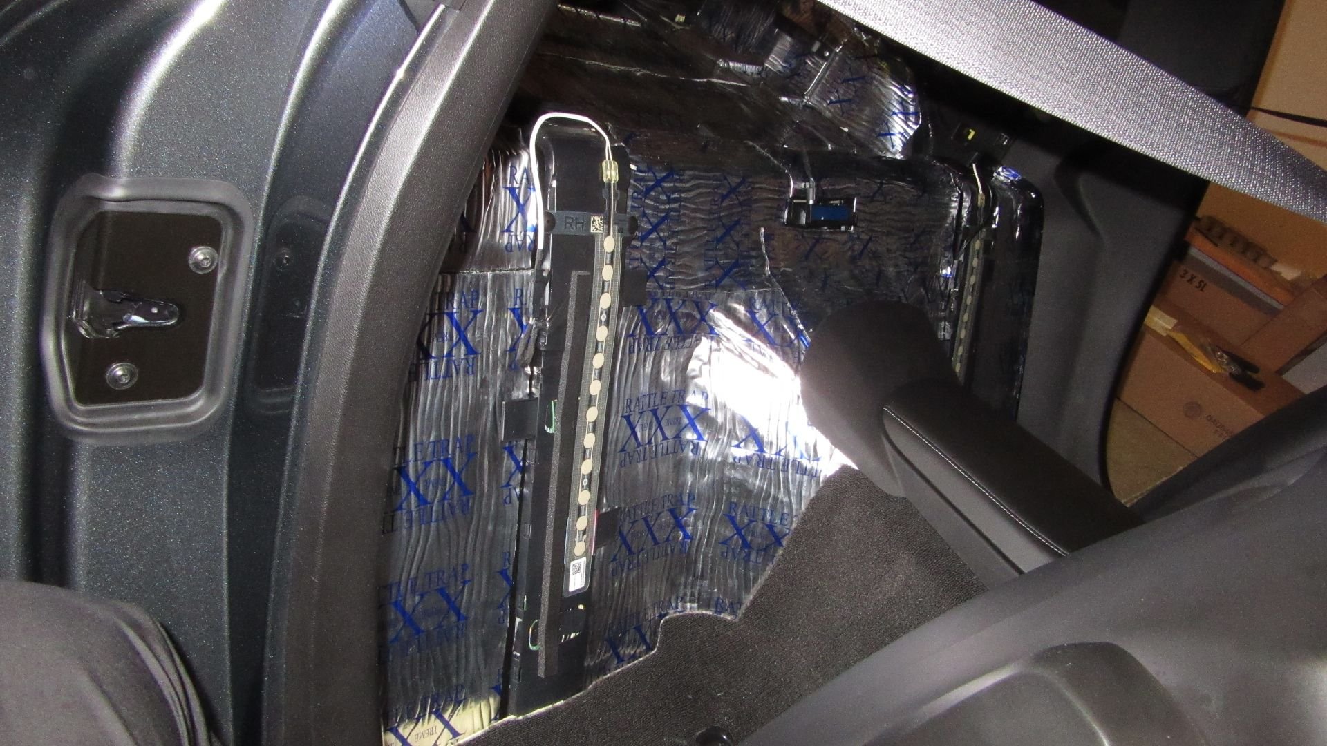

Rattletrap Xtreme + Lloyds Ultimat

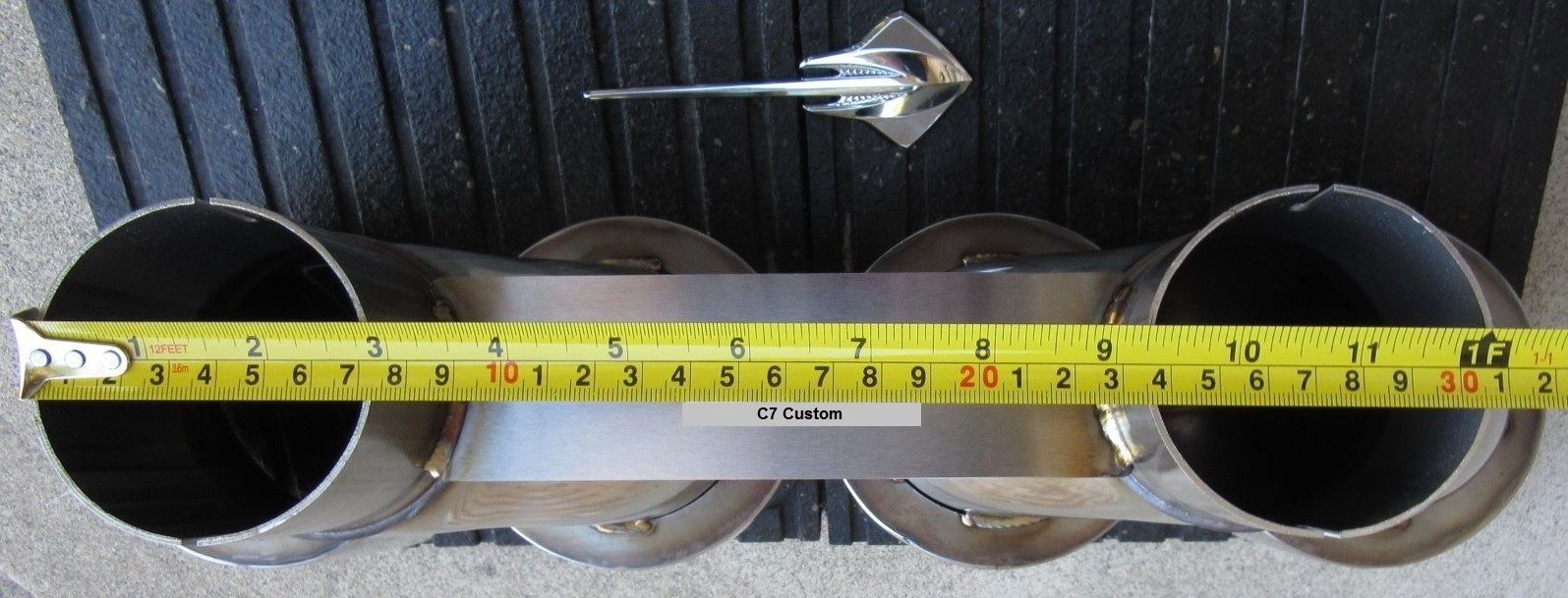

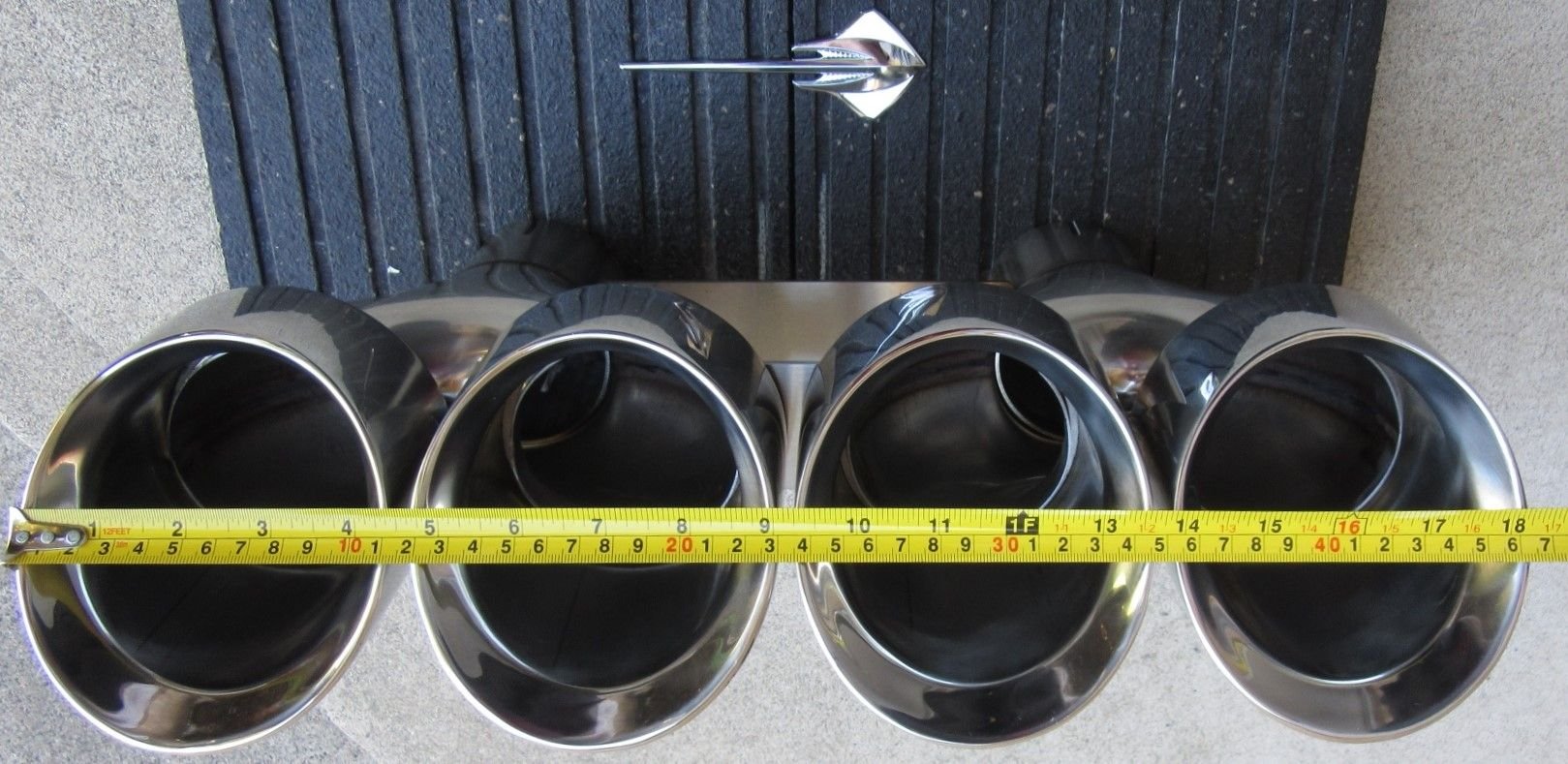

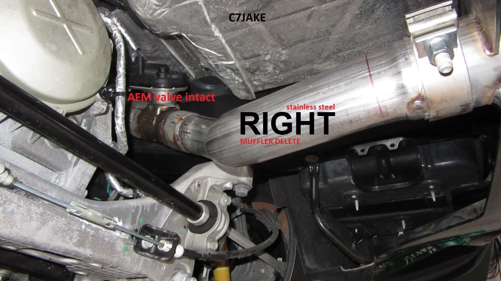

I'm surprised that no one makes a muffler delete set-up for the C7 by now. SLP, Mangnaflow, etc., have muffler delete kits available for other vehicles. I'm sure that the AFM valves are the reason, however, Corsa was able to work around it...
Most people who tool on their cars would prefer to just buy the pieces and install themselves. A couple 2' x 2.75" SS piping with Mendel bends and flared ends would be pretty simple.
Include clamps, a selection of a few tips, and charge $400-$500. I'm certain that these would sell. They have for other cars...

Originally Posted by STStingray
Surprised no one makes a muffler delete kit for the C7.

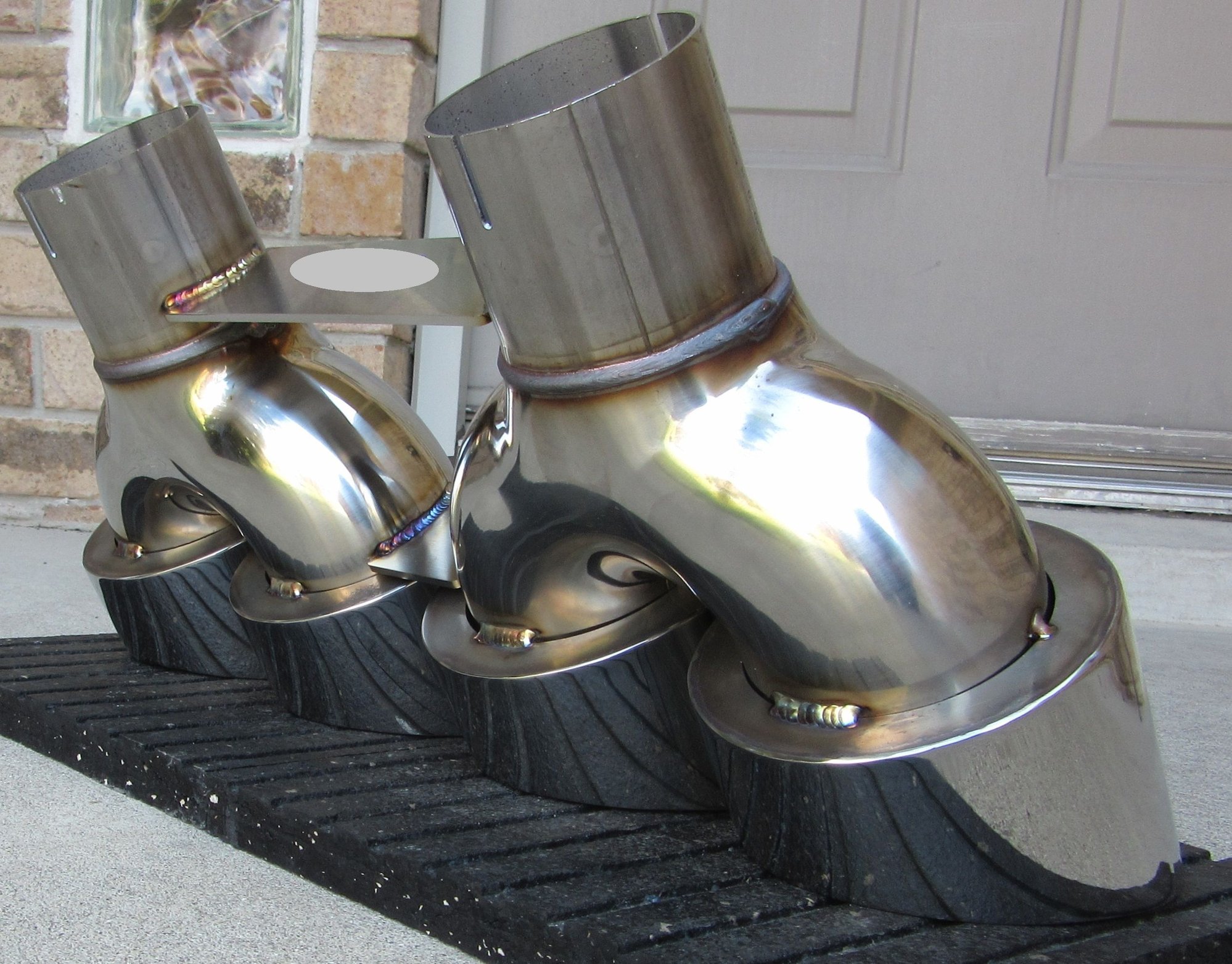

Same here, so I built my own

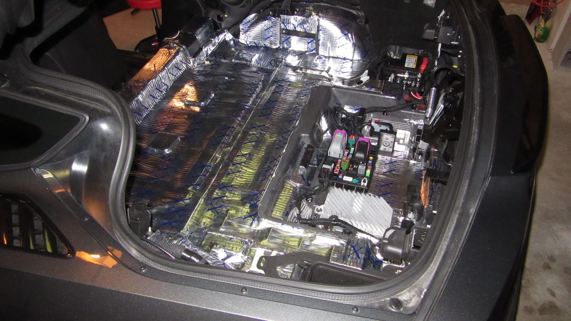

Ok... So it has drone but you installed the sound deadening insulation to cut it down.... So now, let me research that! Thanks for the info!

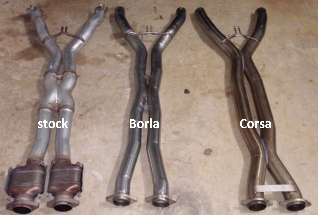

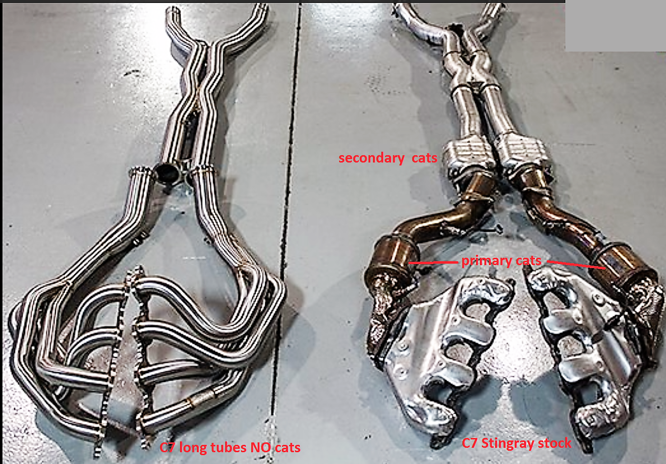

Any thoughts on going with the Borla X, or Corsa's Double Helix, which also delete the non-monitoring secondary cats? It would increase flow, as well as volume, and maybe even smooth out the tone a little- particularly with the latter.
You have a nice set-up; in sound, functionality (maintaining the AFM), and appearance with the Corsa tips, but most people, including myself, usually would prefer to not have a muffler shop cutting away at the OEM exhaust.
It's good that you have a trusted shop available, but they tend to be few and far between, which is why I think that having a reputable exhaust company manufacturing a muffler delete kit would be a successful endeavor.
Any thoughts on going with Borla or Corsa, which delete secondary cats?
Maybe a bit louder...tone/growl/rumble = perfect with the mufflers gone.

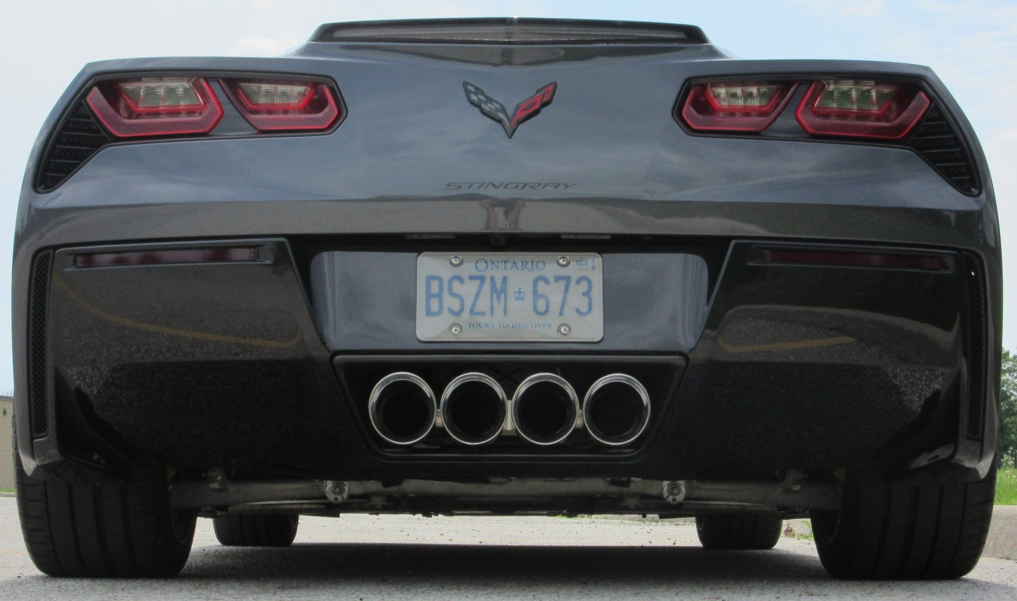

Originally Posted by C7Jake
4.5" tips/NO mufflers = incredible sound
what drone
https://www.youtube.com/watch?v=VoUvCR5ev3g

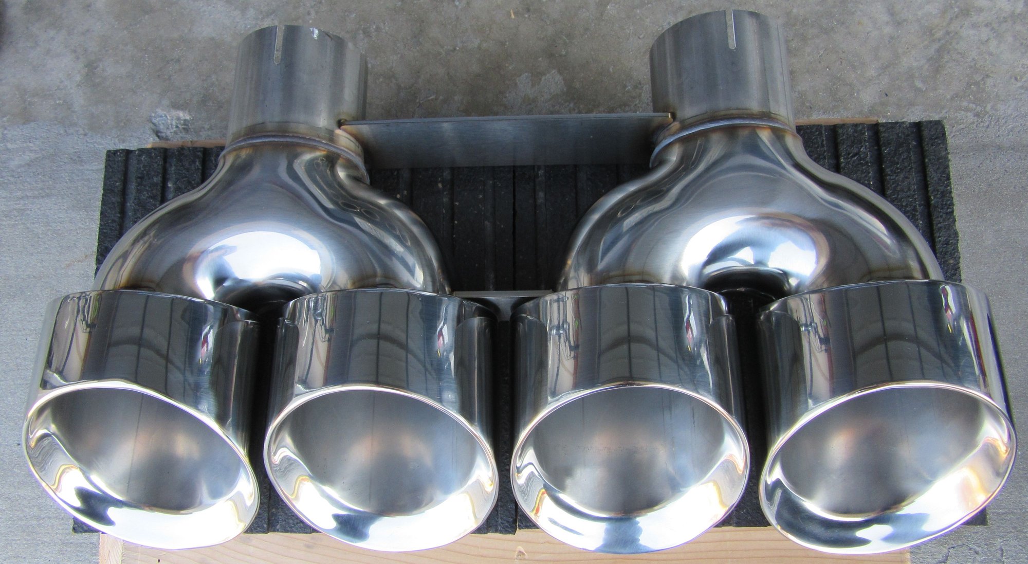

Your muffler shop guy did a real nice job, those are some of the cleanest welds I have seen from a muffler shop. May I ask what he charged you for the work? I may have to go this route as I love those Corsa tips!

Originally Posted by chefcg1
Muffler guy did a nice job, those are some of the cleanest welds I've seen. Can I ask what he charged ya? Might have to go this route...love those CORSA tips!
$200 > 2 hrs
CORSA 14062 tips $280 shipped
25sq' Rattletrap Xtreme $60 shipped
stock tips sold for $80

$280 for tip is a great price, where did you get them for that?
