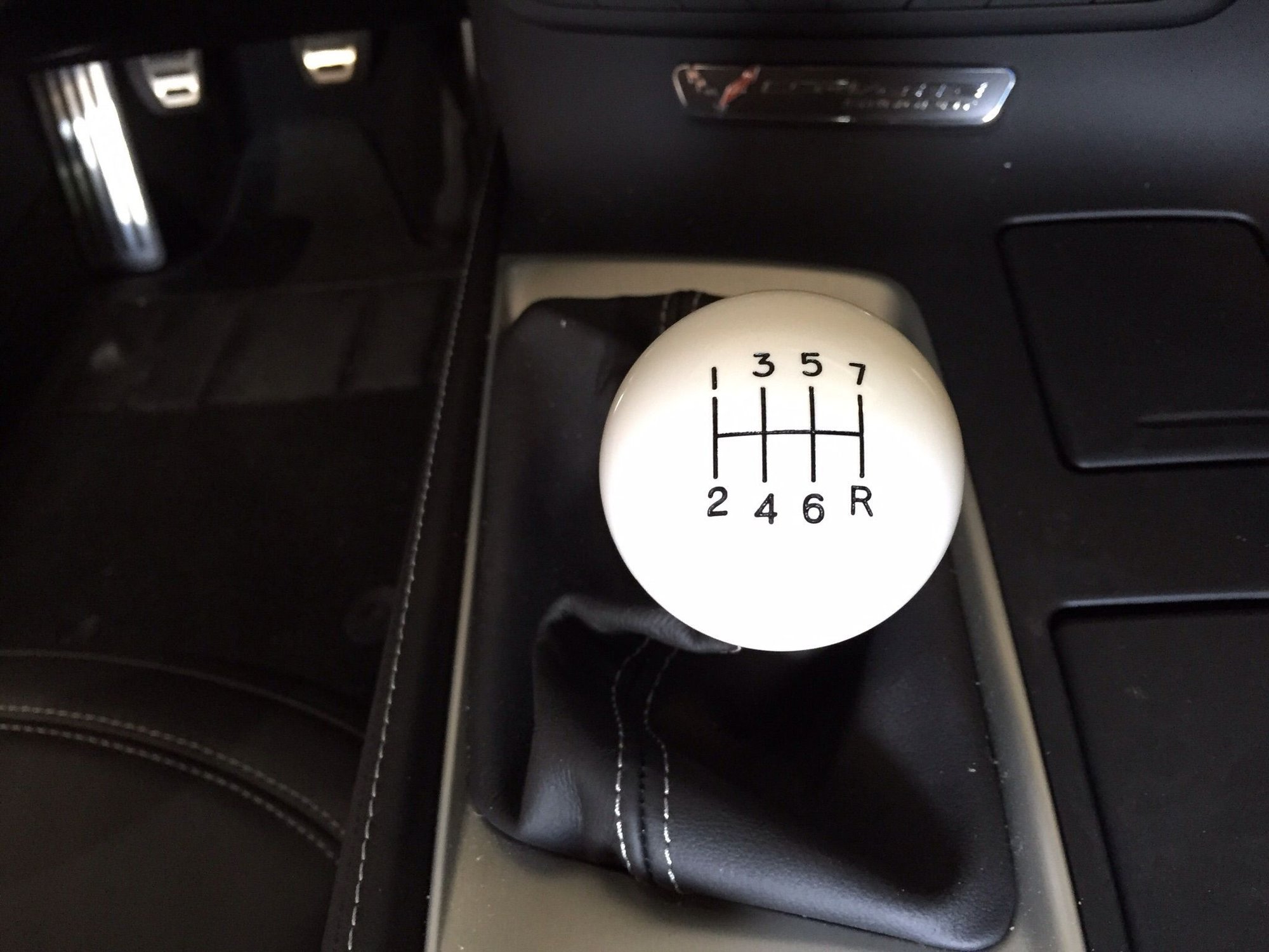

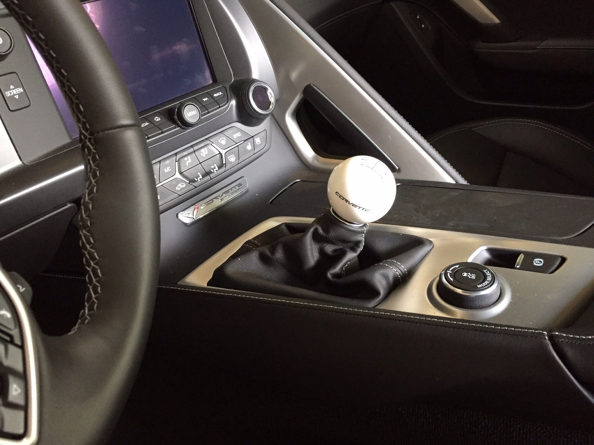

Ordered one of the Top Flight *****, white/black CORVETTE.
Old Aug 23, 2015 | 10:41 PM
dprestidge's Avatar
dprestidge
Joined: Sep 2009
Posts: 919
Likes: 266
From: Ft. Worth Tx.
Should look like this.
