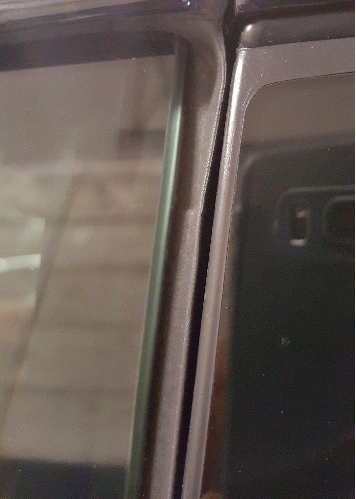

I noticed part of the rubber lining was folded/stuck into the seam. I pulled it out and now it's a little deformed but it's on the inside of the window. I still have the noise also.. seems slightly better but could be in my head.
