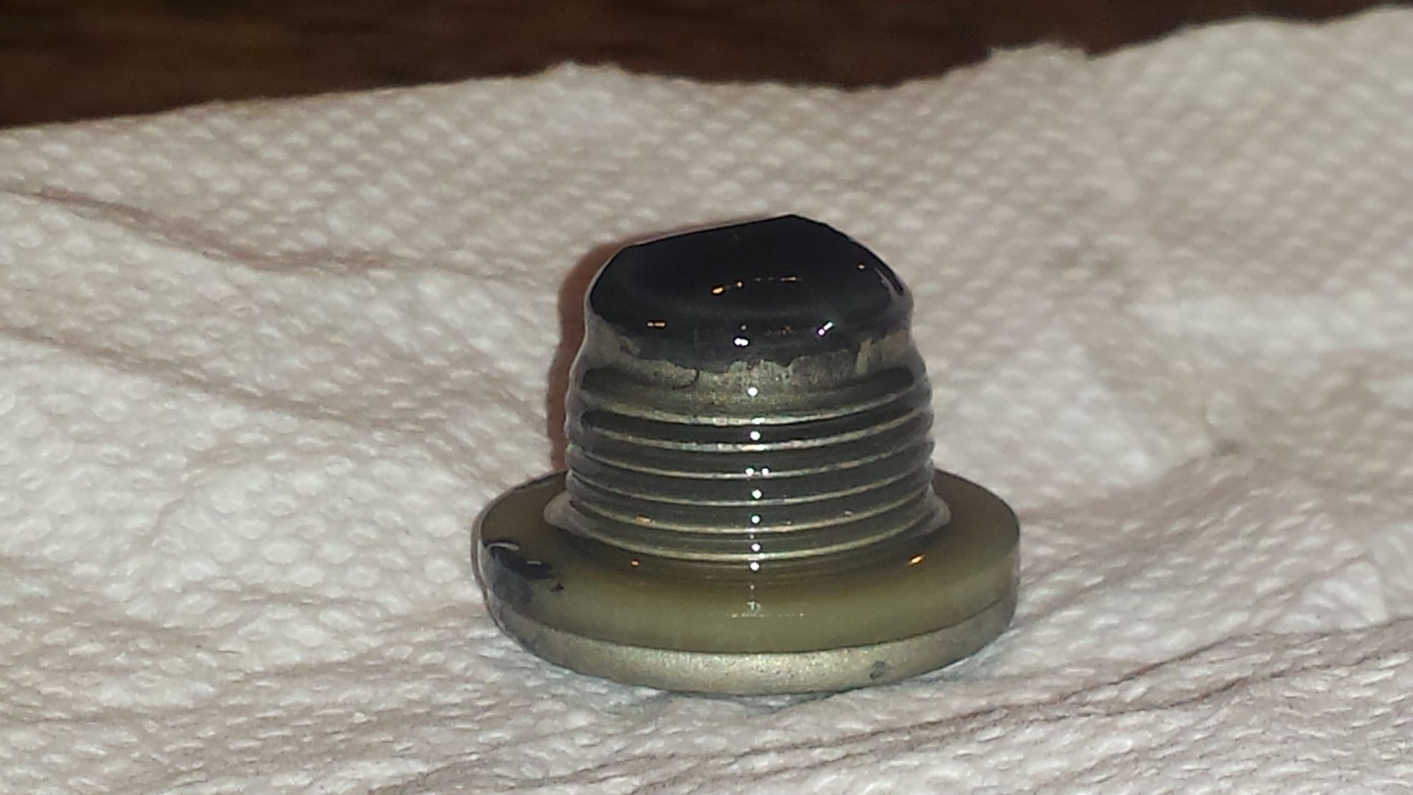

There is another thread going around some of us have been posting in about changing out the diff oil and I had mentioned when I took the magnetic fill plug out to check my fluid at 4k miles (earlier this week) there was a ton of shavings attached to it. So I just drained out the fluid and added Amsoil synthetic to it. Here are pics of the drain plug and the oil I drained out was black. Glad I checked and I will keep an eye on it to see how it looks in a few months.
After I wiped the gunk and shavings off

BTW, my drain plug didn't have as much gunk on it as MikeinAZ shows in his photos, but I only have 2k on the clock.
