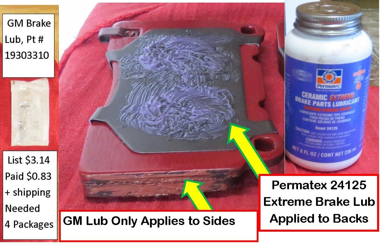

I did the same with Carbotech 1521 Ceramic pads that had tape on the front pads. did not, would not replace it, what a PIA! Just used Permatex lub on the pad backs that is designed to stop vibration. However I also bedded the pads when I installed them. 5 or 6 hard stops from 60 to 20 mph followed by driving without using the brakes for ~10 minutes, then when I did park put it in gear and did not apply the parking brake. Worked fine no noise.
With my OEM pads at about 1000 miles had loud squeal on some very slow stops. Bedded those the same way. Had to do twice and never another sound (just lots of brake dust) so switched to the Carbotech pads. Have not had any noise for the 8 months since I installed. I'd try bedding and see if that helps.
Lubed the back of the pads with Permatex. Rear pads had no shims and I just used the Permatex, no noise.

I'll try re-bedding them. But I have a question, when I installed the new pads I didn't have the GM Lube 19303310 so I used the Permatex on the sides instead. Would that substitution make the brakes make this noise?
Old Sep 6, 2015 | 09:23 AM
JerryU's Avatar
JerryU
E-Ray, 3LZ, ZER, LIFT
Joined: Sep 2007
Posts: 34,982
Likes: 12,383
From: NE South Carolina
I bought the GM lub because that's all they say to use and only say it's needed on the sides. It is much less viscous than the Permatex. However I didn't buy enough, did not realize it came in such a small package. Only had enough for the front pads. However had some old brake pad lub from my street rod that looked exactly the same in consistency and color so used it for the rear, thought the Permatex, which really should work, was too viscous but had I not had that thinner matching lub would have used it.
If a second bedding doesn't do it, believe I'd get the GM lub (inexpensive on Internet but get 4 packages) and clean out the calipers with soap and water, alcohol etc. Then put the lub on the sides. Easy now that you got past the tape and it's your 2nd time! Perhaps the cleaning, perhaps the lub but one or the other hopefully works.
Thanks Jerry. I'll go the the Chevy dealer here in town on Tuesday and get or order some of the GM lube. It's supposed to cool down next week and might be the time to spend some time in the Garage. Do you think I should sand down the rotors and pads prior to reinstall?

I did, it doesn't take much time. I used sanding sponges, 60 grit. I spent about 5 minutes on each rotor so was only getting off some old pad material. Could see it on the sanding pad but not really on the rotor. I read it was best to go perpendicular to the axle, so that is what i did. Don't recall the reason given. Perhaps it took off more old pad material. Doesn't add much time to the job, so why not!
