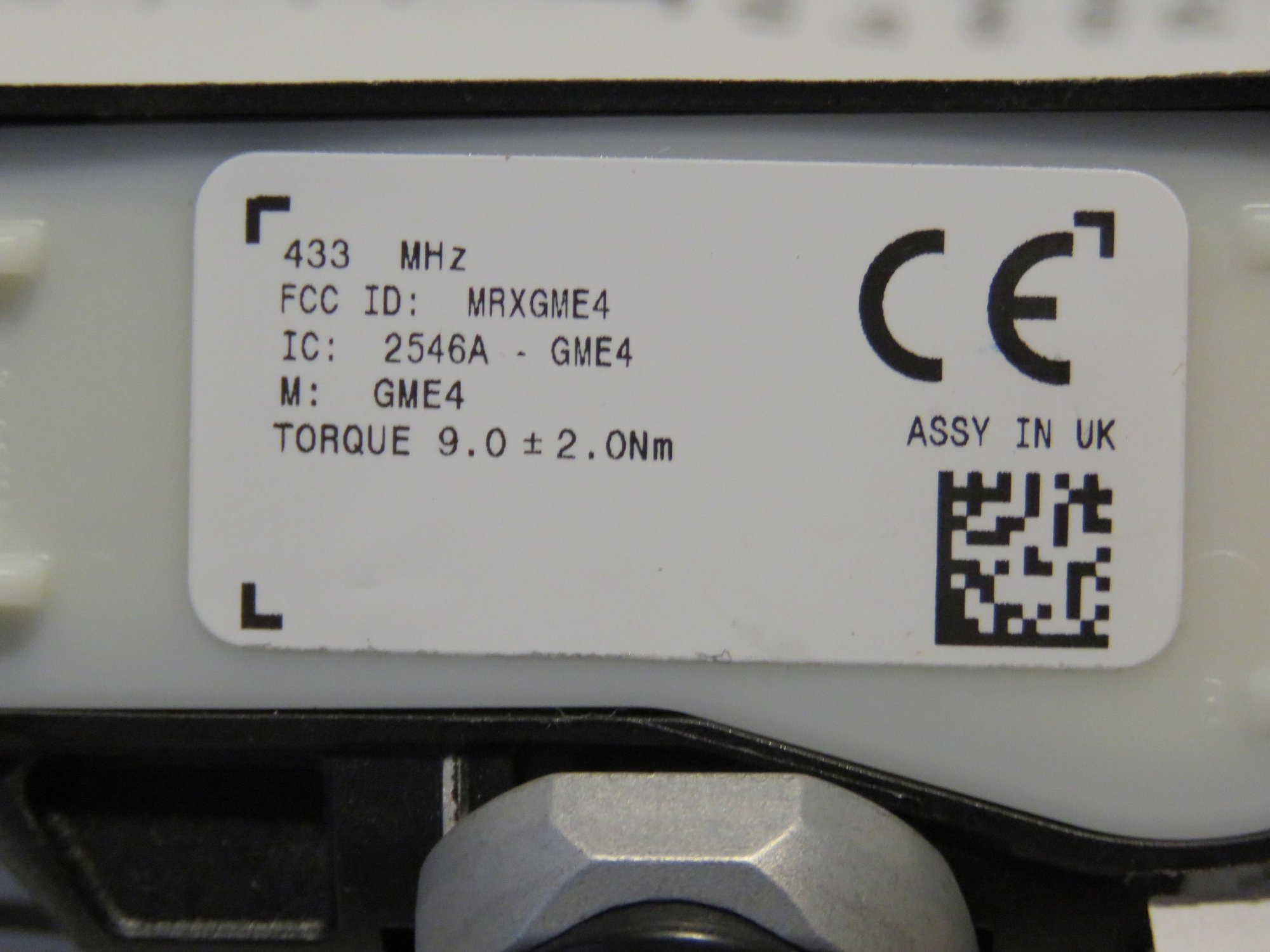

Correct torque is 9 +/- 2 Nm or
80 +/- 17 lb-in
80 +/- 17 lb-in.
Which isn't very much. They will leak if over-tightened.
