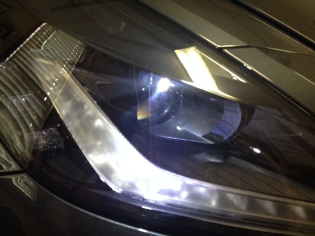

I noticed something strange yesterday at a local car show. It was a very sunny day and my wife asked me what was on my head light. I had never noticed it before and it is not on the outside of the head light but on the inside of the “sealed” unit. It looks like something dripping down the lens and condensation in the corner. Has anyone ever noticed this before? My car is always garaged. Do you think that warranty would replace them?

Yes. Somehow the seal is breached allowing moisture in. Good luck.

C6 headlights are noted for this problem. There is a vent hole to equalize atmospheric pressure. Under high humidity conditions and then followed by a lower ambient temperature, condensation can/will happen. Thinking the C7 has the same problem.

Seems to be dealer's call. Some have been replaced by warranty with dealer help. The condensation will evaporate but can leave residue.

Just an update on my headlight moisture problem. About 3 weeks ago I took the car into the dealership for an oil change and brought their attention to my headlights. The service manager said that that is defiantly covered by the warranty. He ordered two new headlights and said that he would give me a call when they came in. It took about a week for them to come in and he called to schedule a time to have them installed. The dealer that I use is about an hour away so I waited until the weather was going to be nice. So, today I made the drive and got there about 8:00am. They got the car right in and I was out the door and on my way home at 11:00am. Not one scratch, every seem and joint on the front end was perfect and the new headlights were adjusted perfectly. I was very satisfied with not only the service, and the folks at this dealership were great. I don’t know if I can mention them on the forum because they are not a member dealership. I will tell you, they had a beautiful 2016 Torch red Z06 convertible on the show room. Damn near left my car there to drive the Z06 home. I would have been homeless when I got home, but it might have been worth it. See ya!!!!
