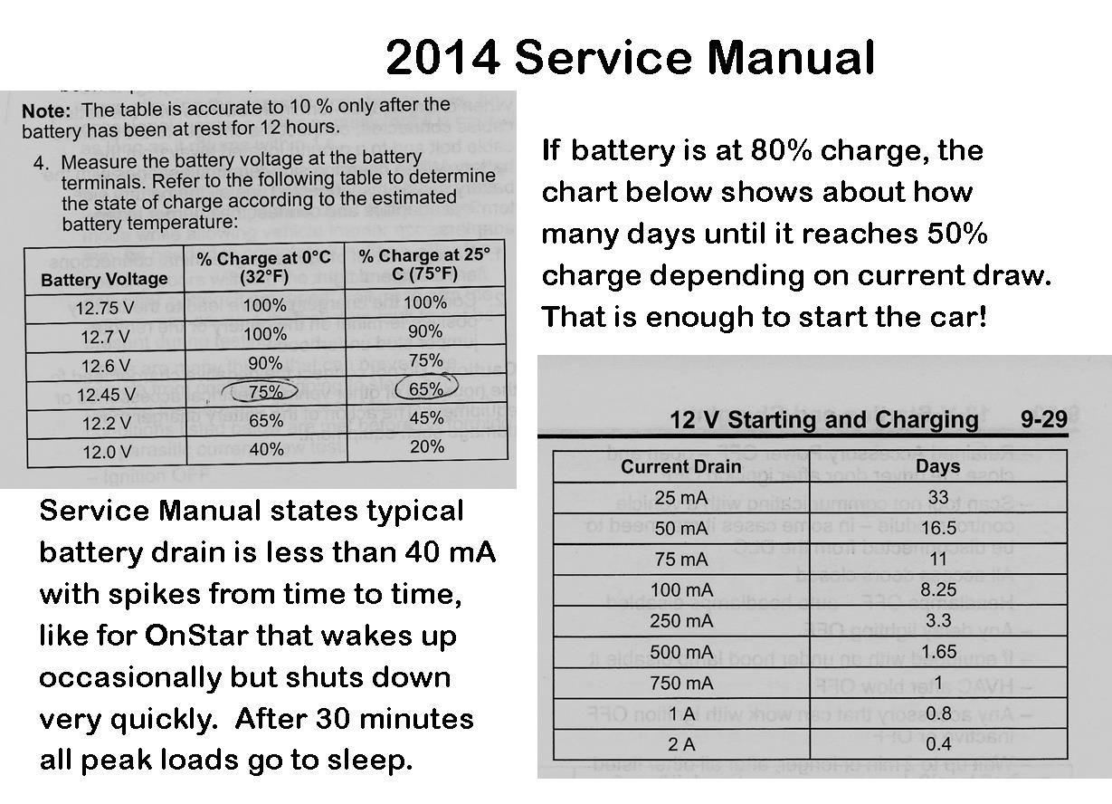

Just to set the record straight, you can do as you wish but the C7 is no different than other cars, better than older Vettes and can start the car at least 30 days after not running!
Got my C7 in October 2013. Checked the battery voltage and it was on the low side (read ~12.4 volts using a calibrated volt meter and still does after the surface charge dissipates.) Had the dealer check in 2013 when I brought it in for a rear end fluid check. As expected I got a "working as designed!"
Have not used a battery charger after I bought a GM equivalent in October 2013 to see if the low voltage was from not using the car during that period because I was travelling, no different and have not used it since. I went on vacation for 2 1/2 weeks and it started fine and after driving ~50 miles the battery still read 12.4 volts! I probably have a weak cell and at the first sign of a problem I'll buy an AGM battery replacement-but so far it's fine.
Made the pic below from the 2014 Service Manual info. It shows that the C7 can last, as noted, more than 35 days and still start the car. Do as you wish but the C7 DOES NOT DRAIN THE BATTERY EXCESSIVELY, IN FACT SHUTS OFF MOST POWER DRAINS AFTER ~10 MINUTES.
If fully charged car should start after 30 to 35 days
Consider the record straightened. I'm aware of everything you point out in the manual. Nevertheless, I don't see anything but good in spending a few cents per month to be certain the battery is fully charged. I've also read that this practice also helps extend battery life.
