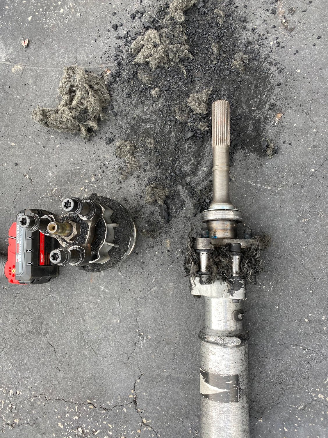

Lol, GM refused to cover repair excusing themselves with following: "Due to the lack of maintenance on your vehicle, there is no cost assistance that we can provide you. There was no maintenance documentation related on your vehicle for the past 4 years. This is a high performance vehicle that needs to be maintained to insure proper longevity."
But this is where all fun begins, I got the part and with help of my son, we started disassembly process to get to this Flex Plate. I needed to loosen the lock bolt on the plate hub to free the drive shaft for removal and then just out of curiosity popped the inspection cover on the transmission end of the torque tube and WFT?!? The rear flex plate attached to the torque converter freely rotates ~ 60 degrees. At this point, there was very little doubt the problem is with the drive shaft and not with the Flex Pate on the crankshaft. It was a good news, because of replacing front Flex Plate is more involved as it requires to drop engine with subframe by 25mm to get to the bell house bolts on the top - Thanks, but no thanks!
Interesting fact - GM asked me to bring car for diagnostic and technician looked at the car to diagnose the issue - he never even bothered to check the transmission end, so he just put Flex Plate as cause of the issue. What kind of technicians GM is hiring? BTW, the front drive shaft bearing was not recessed and looked very normal. Anyway, I was expecting GM technicians to be a bit more proficient and do their due diligence while at work.
DIY, is not simple as there is no video or any info on the forums for C7 and mine has Z51 that complicates things even more with electronic differential lock. We only used GM Service Instructions for torque figures, most of the process described is idiotic endless disassembly of just about everything there is there to take apart. Installation instructions were even worse as they would cause potential damage to engine thrust bearings, if you follow those. Simple rule - you should not force driveshaft into hub, following instructions will make you do exactly that, so you have to think out of the box about how to alter process to get everything to join without "brutal" force.
First time is difficult, but when you know the "easy" way it is not bad at all, just tedious.
We are still puzzled how this could have happened, we purchased car with 40K miles on odometer. Initially we thought some strange sounds is part of corvette experience, but those became real bad after +20K miles. The bearings are fine though, only dampers should be replaced and it will be a nice backup. We swapped torque tube with used one from eBay we got just in case we need one during repair.

On second thought, I am glad the dealer was not involved in changing it, because of they most likely would "force" shaft into flex wheel hub by following dumb GM service instructions and cause damage to engine and shaft. Some unlucky folks who had issue with drive shaft, ended up with in some cases with 3, 4 times shaft replacements that ended up with damaged engine fiasco. So, yes it would be nice for GM to fix it, but a 1000 miles later I might regret it big time. As my car is out of warranty I should not take this bargain even if GM would offer to cover the cost.

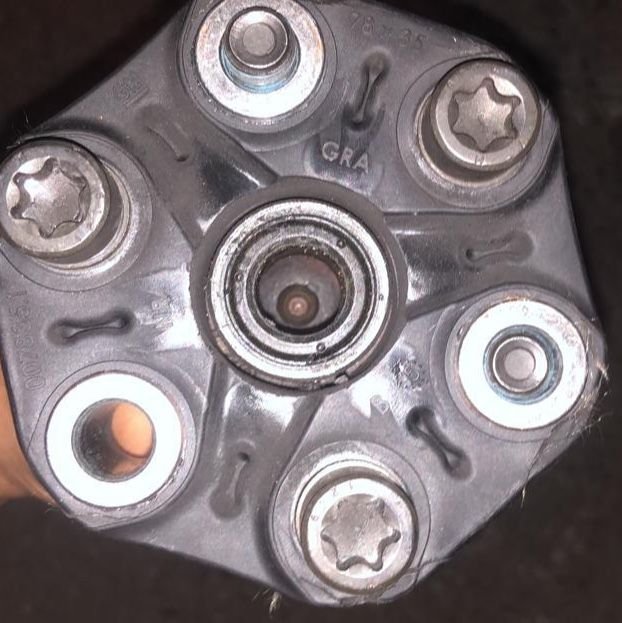

Usually, the shaft bearings are busted, but in my case, bearings survived and the only thing needed was new couplers, but there is no way to purchase it. RMP Transmission would sell it to you with phone order for ridiculous price of $200 each. So at $400 a pair - it makes repair not economical, because of you can get brand new drive shaft from GM for ~$1000 with 1 -year warranty and do not bother with old shaft at all, just return it for core refund of $400, that makes final price of $600:
PN 19302510 - Drive Shaft - Without z06. Manual trans
PN 23366290 - Drive Shaft - Auto trans. Without z06. With z06, grand sport.
C7 coupler size:
Number of bolts - 6 M12x1.5
Bolt hole diameter - 12.05 mm
Bolt pattern diameter - 78mm
Sleeve length - 35mm
Bolt mount length - 38.45 mm
the coupler has 007835.1 printed on it.
I passed this information to Dorman - so may be they will start making those couplers and sell it at more reasonable price of ~$60, like they do for older Corvettes.
Be safe, and enjoy your Corvette.
I found this photo of the slightly damaged coupler on this forum, as mine were mutilated completely.

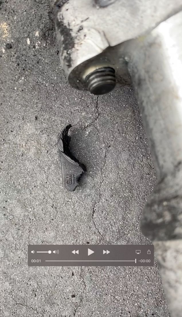

Wanted to post on here too. Just got my 19 Stingray back after a week at the dealer. I picked the car up n March of 18. 24K miles on it. Couple months ago. I heard a rattling sound which I thought may have been exhaust related due to aftermarket x-pipe being installed the previous fall. I took the car in and they could feel the sound resonating through the x-pipe. I got my stock pipe from home and they swapped out the pipes, which did not eliminate the sound. They started to go further in to check the torque tube. Rear yoke on the propshaft was loose. They replaced the torque tube and flexplate per the bulletin. The flexplate they replaced it with is from the LT4.

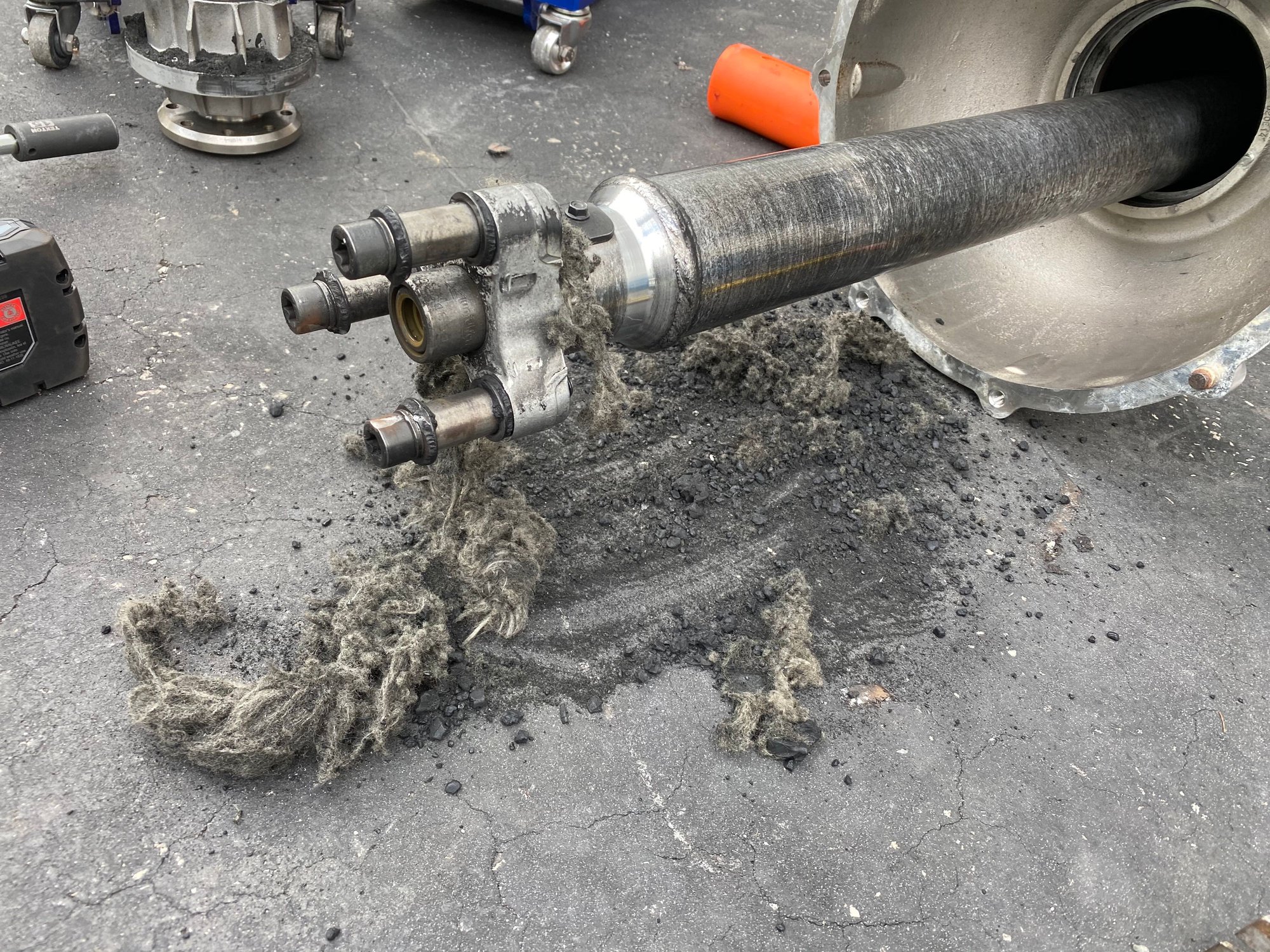

10K miles later and used torque tube (had 60K when we bought it) failed as well. We never disassembled it to verify condition of the propeller shaft. Apparently, it was going the same way ours went. This time we purchased new propeller shaft from the GM PN: 23366290 with warranty and just assembled it to our original torque tube from the first swap. Will see how long it would last. Second replacement was a way easier, as we knew how-to do it "the right way".
Torque Tube - failed

Just for info: When there is any tiny play in flex plate, hub or bearing to tube body - there will be noise associated with the source. Following service manual you suppose to hand tighten flexplate hub clamp before first engine start to get through temperature cycle. Hub to shaft interface was rattling so annoying (there is a free play by design to allow assembly/disassembly) - we have to stop cycle and tighten clamp more securely to stop the rattle during this step and perform final torque for the clamp. The back of the driveshaft assembly is not super tight either to allow disassembly/assembly, so it can make small ticking sound at idle. The front bearing is not super tight for the same reasons, but there is a small rubber ring damper there to cut any noise.
