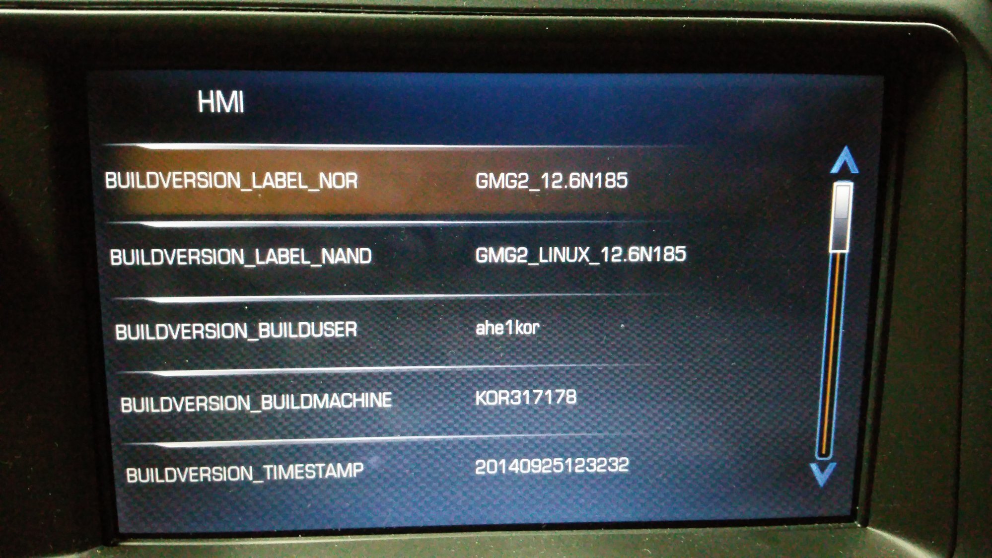

I went and did that yesterday and got these versions. I know the map version will change but I'm very curious if the map SW version will change too.
Main HMI software page.
MY14 HMI 2.0 with SW 12.6N185
Navigation page which I believe was near the bottom.
Nav Maps 2013Q2 v6_oS with SW 12.2C2P28

It looks like there might be a newer version of the HMI firmware for your vehicle. I found the Bosche Open Source Software repo and it lists a build newer than what you have. I'm comparing the source of versions still to see if it contains what might be the differences between versions.
Your Build - 15.1A044
Latest Build - 15.1A052
My speech to text stuff is all from Jan 2013 too. Looks like the 12.6N185 version is the latest build for MY14 cars so no updates for me unless I jump HMI modules.
