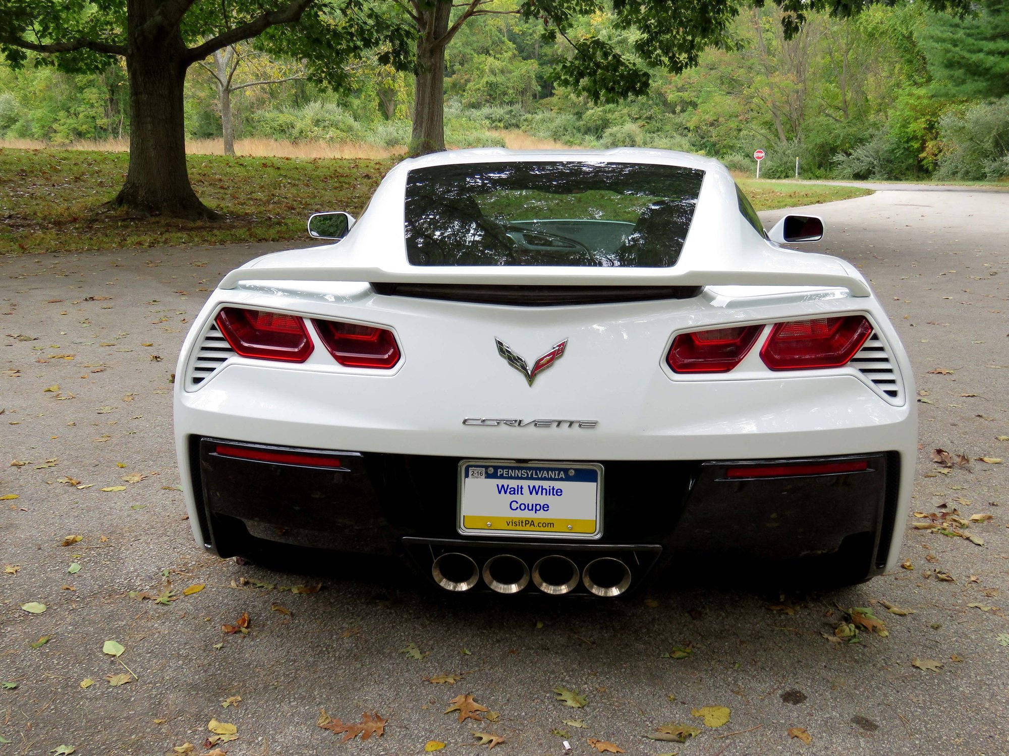

Old Dec 9, 2015 | 10:26 AM
Walt White Coupe's Avatar
Walt White Coupe
Joined: Jun 2005
Posts: 10,909
Likes: 2,701
From: Phila Suburbs 2023 C8 & 2013 650ix
And here is what the NPP exhaust looks like.
