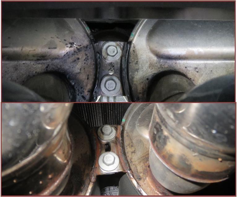

PS: Assume you meant the stainless tips NOT the pipes as you posted. If you really mean the pipes you first need to deal with the rust on the welds, weld spatter and the backs of the mufflers. Below is a pic of what I used 2 years ago and it has held up fine. It's called Rust Reformer and under $10 at Walmart. It's NOT a paint. Looks like milk when going on and turns iron oxide (rust) a blue black. It only changes the color of iron oxide so you can just put in on the whole area with a long handled cheap brush (which I used) or even a rag. Unlike high temp paint it does not peel and there is no masking etc. If you want to know why the aluminized stainless used has rusted here is a PDF of what I did and an explanation of the issue: http://netwelding.com/Muffler_Rust.pdf
Bottom: Before Rust Reformer; Top After Applied

Note, if your muffler ends and welds haven't rusted yet, they will! This has been an issue before the first production! I recall seeing it on the first C7's I saw, which was after I placed my order! That was on the 10 to 12 what GM called IVAR's, that were at Laguna Seca Vintage Races in August of 2013. Those were some of the ~100 preproduction models that operated for over 6 months before production started.
