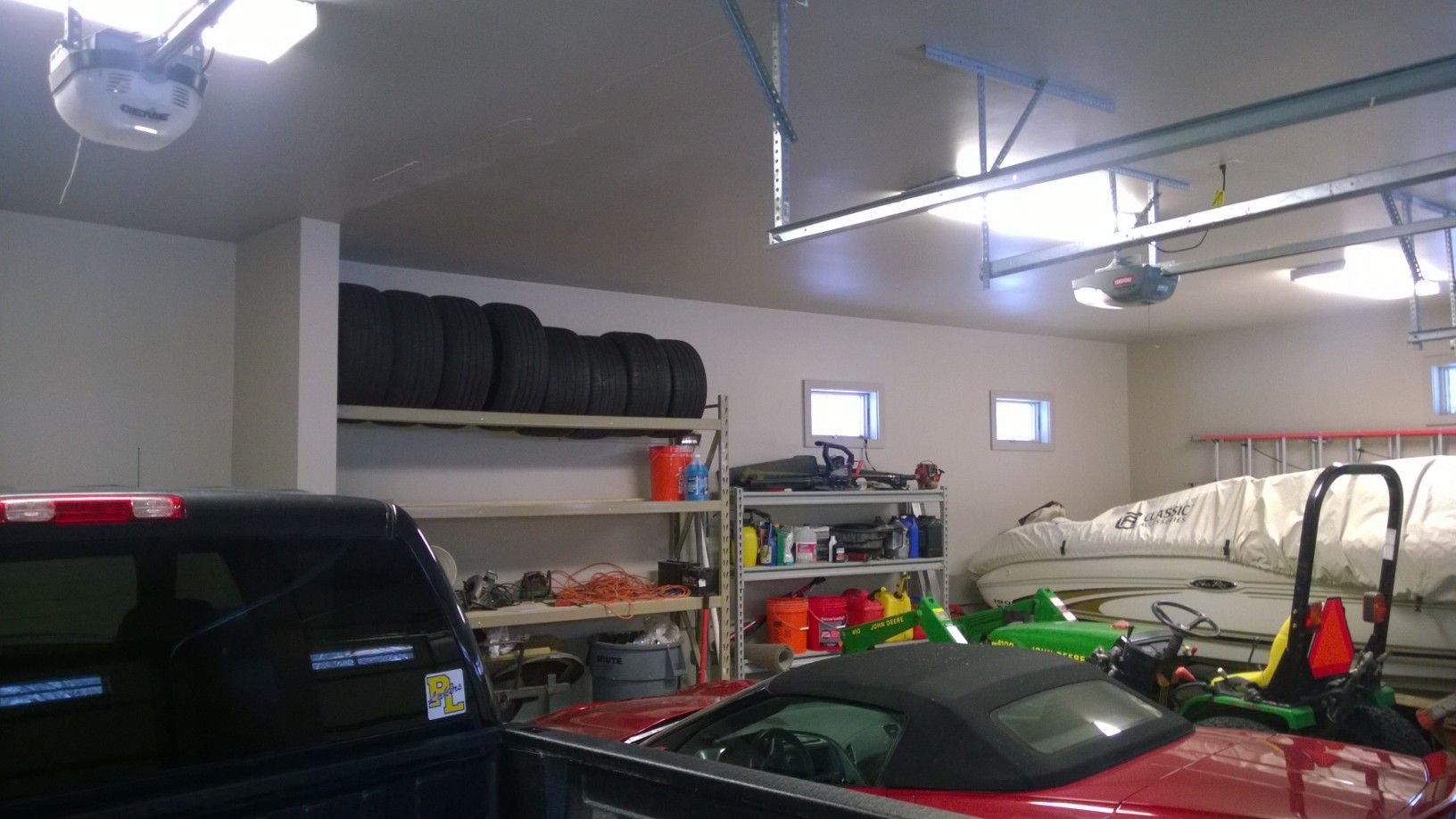

Can't really use it much until the ice melts, so I drain the cooling system to avoid freeze damage, put the battery on a trickle charger, fog the cylinders, put stabil in the gas tank, and store it under a cover on a trailer in the far corner of the garage.
That is what I do with the boat. What I do with my Corvette during the winter:
I drain the entire tank of gas multiple times (through the fuel injectors and combustion chambers).
I keep the battery topped up (using the car's in-board charging system).
I keep the tires from getting flat spots (by driving at least 60 mph once or twice a week).
I do confess to using a touchless car wash to rinse the dust off (and salt).
I store the summer tires on a shelf along with the crappy summer performance tires that came on my wife's Ford Explorer Sport.
