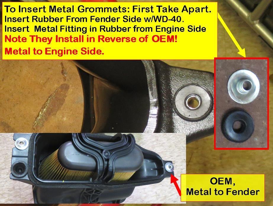

I installed my AFE this past weekend and it was a bitch. I had to remove one of the rubber grommets because the stock bolt was not long enough to reach with the grommet in. I tried for an hour to get it threaded and it would just not go. Removed the grommet and finally got it threaded. I'll just have to live with it.

Don't know if this had anything to do with your issue but the rubber grommets install backward from the OEM box! This is one of the 20 pics in my PDF install, see post #3:
Rubber Grommets Install Backward From OEM Box

I tried forwards backwards upside down and nothing worked. I even had a buddy pushing the airbox into the fender and it was just to short. Took the grommet out and it gave me the clearance to fit. The large washer should be enough to secure it. The other grommets worked and its in there very tight so should be ok

I forgot about it but now that you bring it up I had some trouble as well. Mine was with the bolt closest to the front of the car. I messed with it for awhile and finally got it. At the time I thought it was more of an alignment issue because when I finally got it it threaded right in. Maybe a combination of alignment and bolt length?

See mine was the one closest to the firewall. The one towards the front slipped right in.

I had the issue until I got the rubber/metal grommets right. The confusion is the OEM is the opposite. Their instructions show it properly but they don't say it's backward from the OEM!
