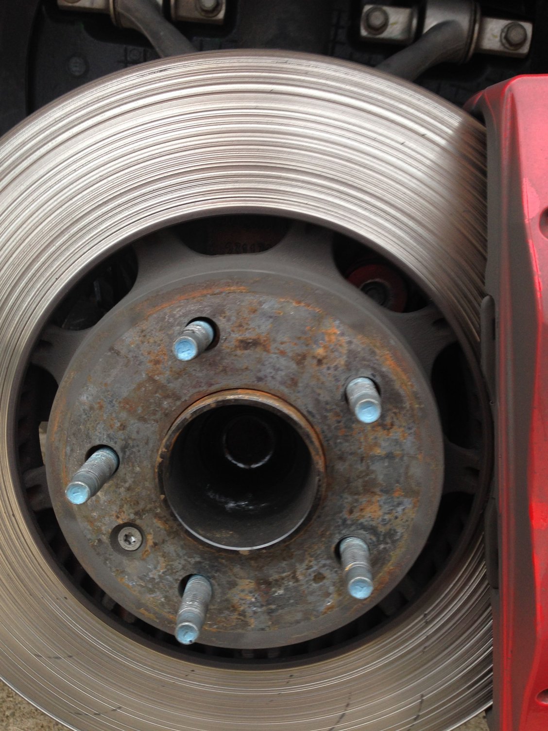

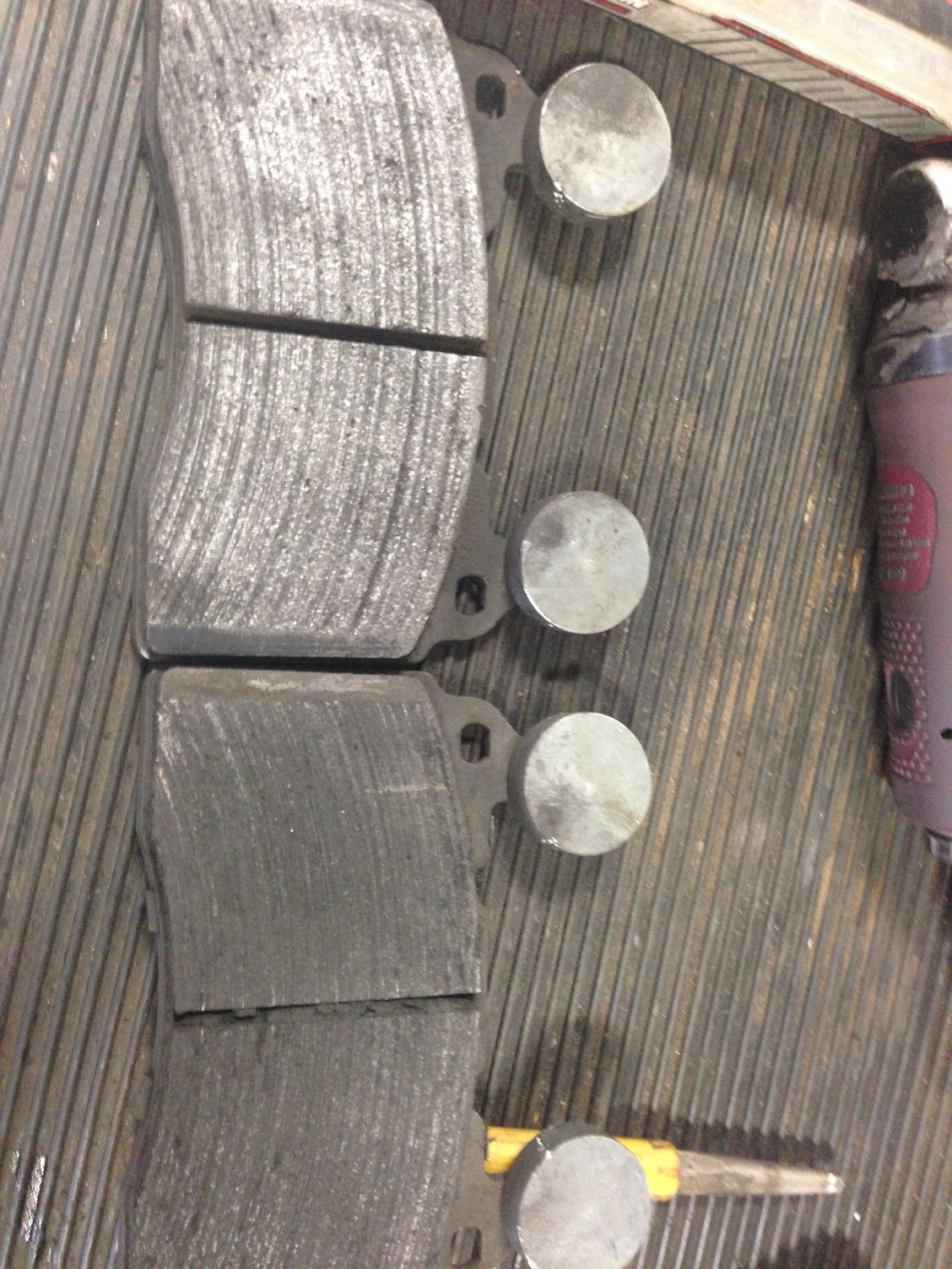

My goal now is to run the hottest pad I can without burning up stock rotors autocrossing , I thought about dropping down to HP Plus ( that's a dated compound) from the streetrace pads but once hawk released something better than HPS's (HPS 5.0) I knew this would be rotor safe and a step or two up from stock.
This was a z51 rotor, you don't know what noise and dust is until heard this set up
It's not brake dust I'm cleaning out , it's factory z51 rotor!! Lol
