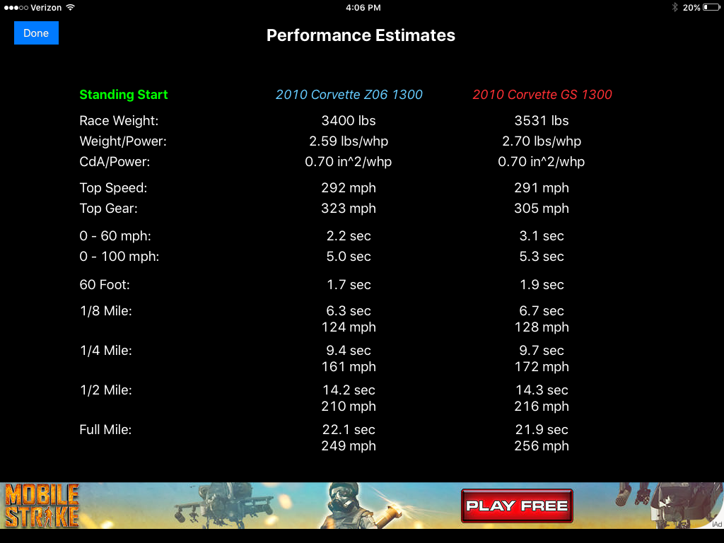

Steve Haefner's Avatar
Steve Haefner
Joined: Dec 2015
Posts: 488
Likes: 59
From: New Melle, Missouri
2018 C6 of Year Finalist
Originally Posted by JoesC5
Something is wrong with your "Bench Racing" math.
The C6 GS coupe has the same areo drag as the C6 Z06 thus they should run the same speed with both having 1,300 HP(and both with the M6 transmission).
You show the GS A6 with a higher speed than the Z06 which is impossible since both would have the same horsepower. The GS will most likely have a lower speed as the A6 has a higher drive train loss vs the M6 in the Z06, thus less horsepower will be reaching the pavement with the A6.
Top speed by gearing alone for the GS A6 is 222 MPH in 5th gear at 6500 RPM where as the Z06 is 219 MPH at 7,000 RPM in 5th gear.
The overall gearing in 5th gear will actually help the Z06's accelleration as it is lower, but the 500 RPM higher redline in the Z06 makes the speed virtually identical.
You are right.. had a minor aero differences (user error) in the calculation (fixed) and I decided to get the HP closer, hard to do with the way this app works. Here is a screeny of the results.
Calculations are on WHP not crank, from a dig, street performance tires no drag radials.
GS A6 with 1308 WHP
Z06 M6 with 1313 WHP
transaxle
6l80e 4.027, 2.364, 1.532, 1.152. 0.852, 0.667 - 2.73 gear
t6060 2.664, 1.783, 1.302, 1.00, 0.741, 0.502 - 3.42 gear

JoesC5's Avatar
JoesC5
Joined: Sep 1999
Posts: 41,732
Likes: 1,718
From: Springfield MO
GS A6 with 1308 WHP
transaxle
How can two cars with the same identical frontal area and the same identical coefficient of drag, same identical tires, and the same identical horsepower have different speeds in the 1/4 mile, the 1/2 mile and the mile?
The Z06 weighs some 180 pounds less than the Grand Sport, so it should also accelerate quicker in the 1/4 mile, the 1/2 mile and the mile. The Z06 also has better front/rear weight distribution, so that should also help with traction from a dig.
With identical engines(same horsepower at the flywheel) the Z06 with it's M6 should have around 3% more horsepower at the rear wheels than the GS with it's A6. That alone should give the Z06 a higher speed over the GS with an A6.
