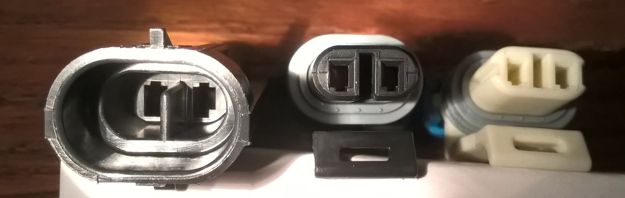

I have seen some suppliers selling the eliminator that says it will only fit a C7 and not prior years, but I am not sure if it is the connector that is different or the resistance is different.
For reference, I have seen two styles of connectors... They are the same size except one has a partition in the male connector so it can only go on one way, and the other does not...
Look up inside the connector on the transmission and see if there is a partition like the plug on the left in this photo.
Also note, the skip shift solenoid is WHITE, and other connectors for the reverse lockout and temperature are BLACK which should help identify the correct one to unplug.
I just removed my fuel door actuator and it had a connector that was the same size, except it had the partition. I used an old skip shift eliminator (without the resistor) to cap the wiring harness plug, and it fit fine.

The connectors are different. The one with the divider in the middle (left side of photo, above) doesn't fit C7s.

As pointed out in my note, the male connector on the left would be the one on the solenoid. The wiring harness plug would be one of the two on the right.
I have not actually unplugged mine to look on the C7, but I think you are correct that the connector that is part of the solenoid should not have the partition. The photo was just to point out that the partition should be the only thing that would keep the white plug from going on. Otherwise, they should be the same size. Obviously, you still have to make sure the locking clip is on the correct side before it will plug all the way in.
