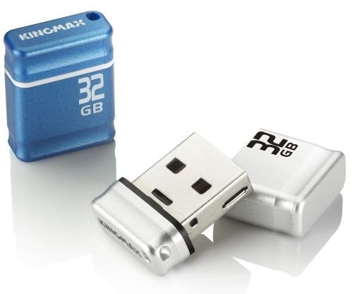

Yep but you can buy flush mounted memory that fits in the USD slots.
There are a number of flush mount memory devices available, Google.
