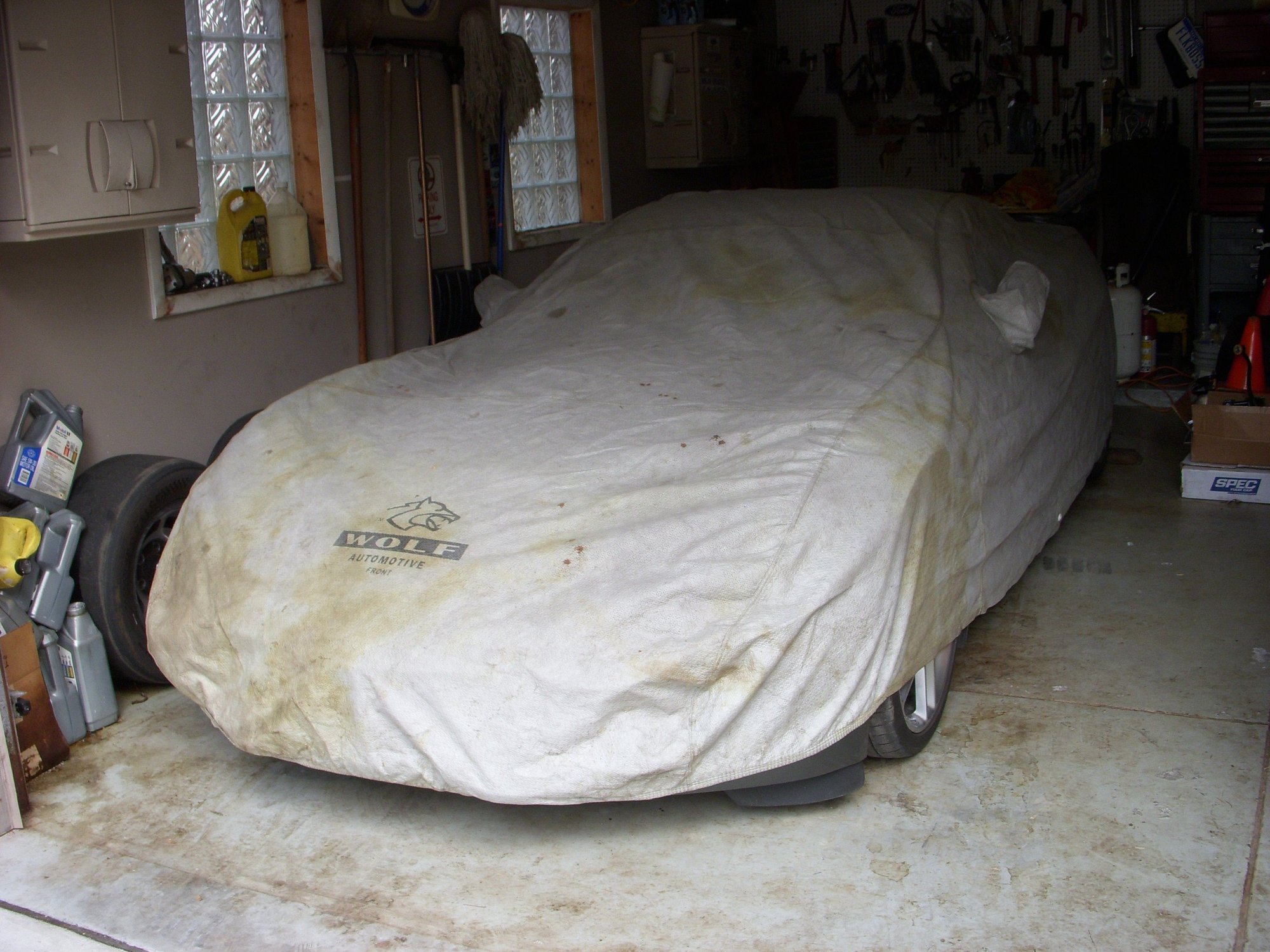

I know it's a bit dirty, but, clean inside.

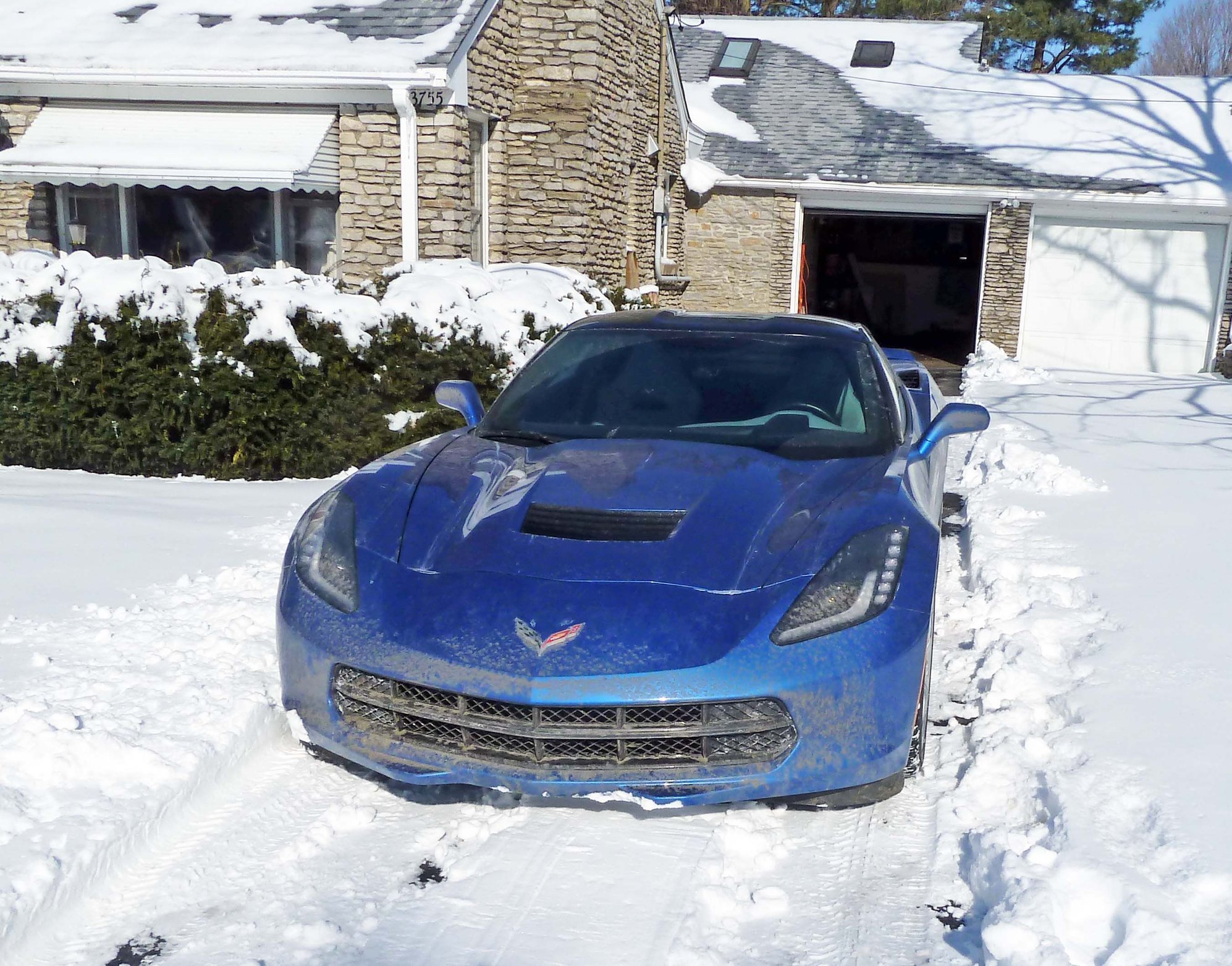

I drove mine recently, last Sunday afternoon. I just pushed the stop button, it is going to be a week or two (optomistic) until it gets fired up again, darn 30" snow storm. If it sits any longer I will plug in the battery tender.
