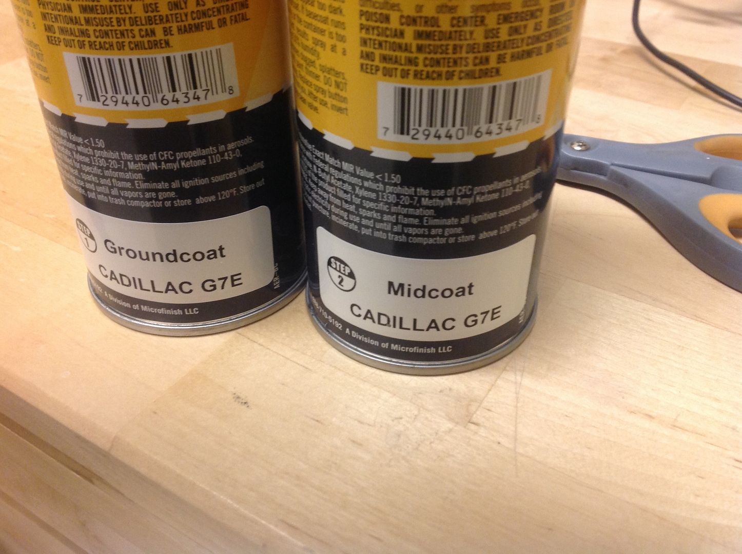

Tint coat is two diff base coats, then clear. At least that's what automotivetouchup.com sells me when I want to spray my garnet tintcoat color.

Tintcoat has little to do with metallic, it's just a combo of a few layers to give a diff look. You can spray metallic with a single basecoat, like cyber gray. As everything still gets a clear coat, durability should be the same.
I have read that tintcoat is a tinted clear, that is not proving to be correct in my info search. Once again, I think GM is saying a few diff things about tintcoat layup.

They label it as Long Beach Red Metallic Tintcoat. When I get it from automotivetouchup I only get the base color, there's no ground and mid coat like glen e gets. When I spray that, it definitely has flakes in it.

It's still a two step color paint process. Red tintcoats have red base coat and red tinted clear. Tricoats are the ones that have a ground, mid, and regular clear. All other colors have a base coat, whether it be metallic or not, then a regular clear.

PPG calls it basecoat, mid coat and clear coat or can be considered 3 stage. The mid coat is transparent and is called tint coat from Chevrolet. To get the final "look", the tint coat is necessary and than clear coat on top of that.

correct... same as I posted above...the two cans; 1 and 2, and then clear...and what automotive touch up explained to me...so I think "tricoat" and "tintcoat" are the same...just diff lingo...
