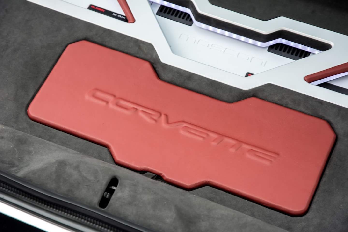

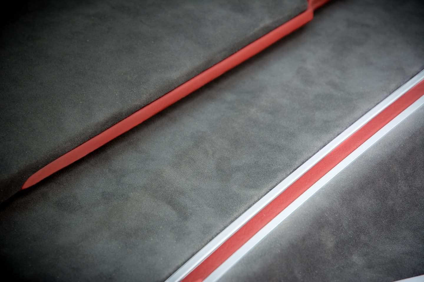

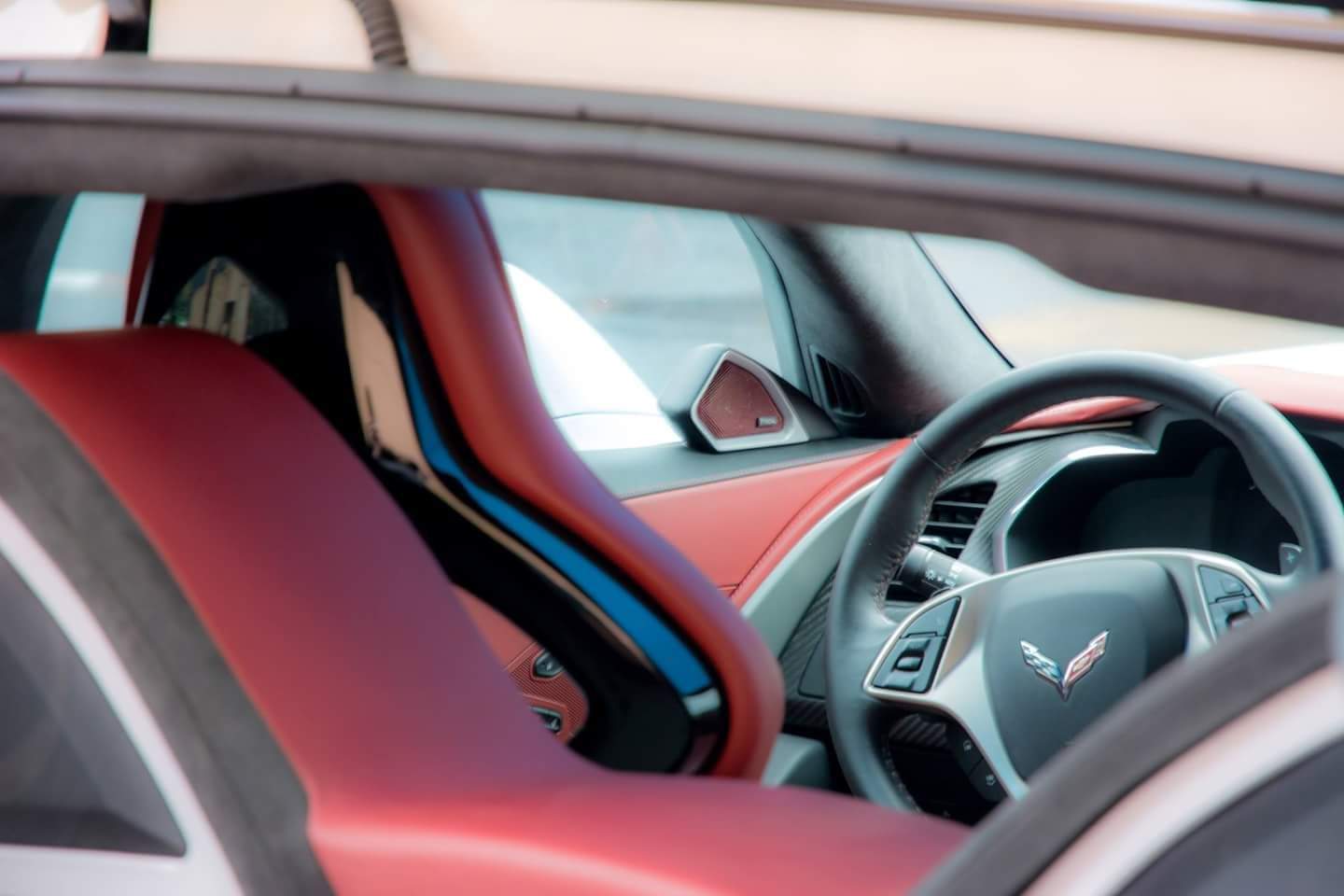

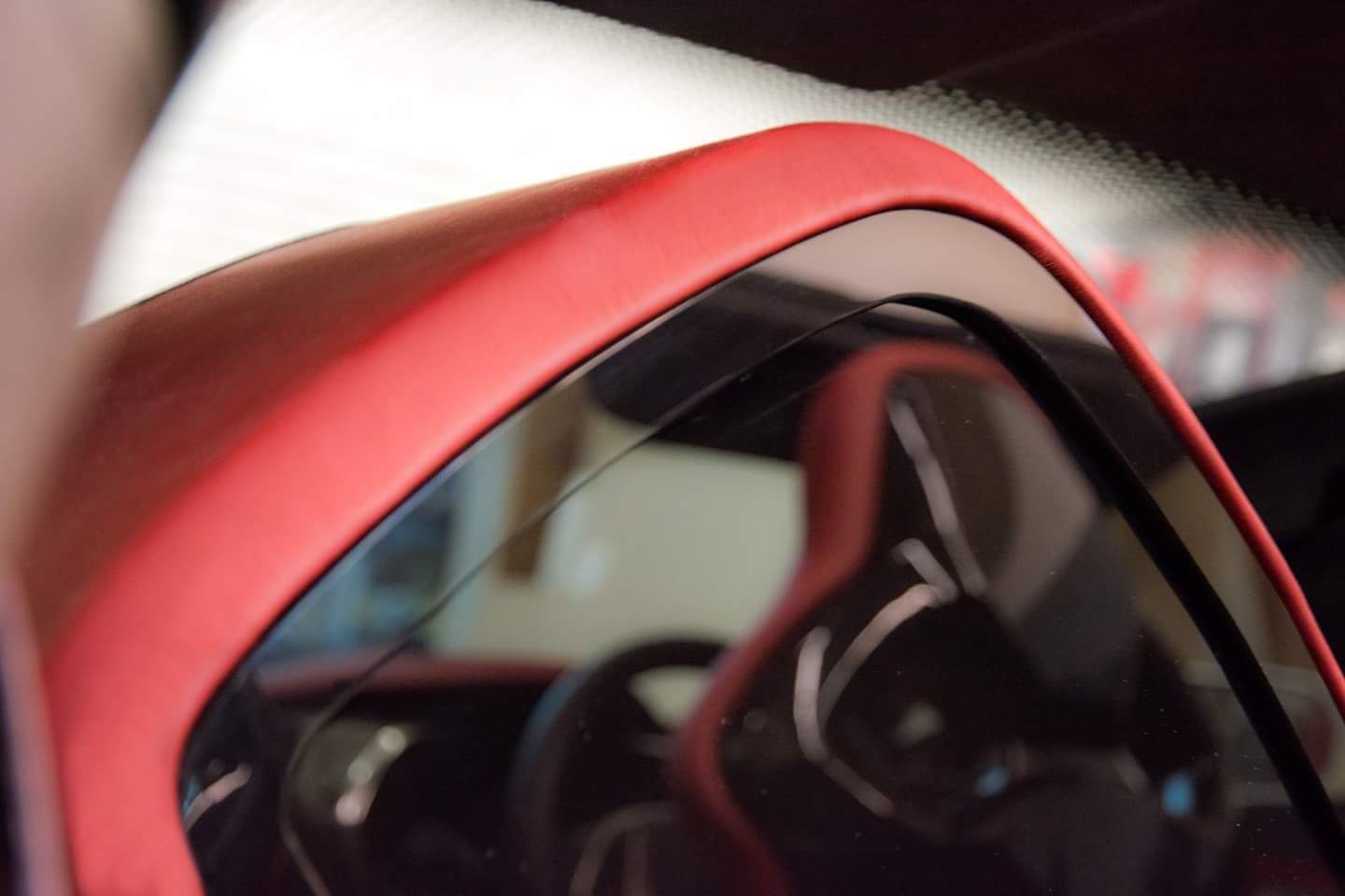

Finally complete
The tweeter pods are made of 100% cast cell acrylic, layered together. The front trim ring is brushed aluminum to match the accents on the door. The front trim ring / grille assembly attaches to the pod with magnets for easy access. There are threaded 1/4-20 inserts mounted into the bottom of the pod for a secure mount to the door panel. Only thing that is not pictured is to wrap the rear insert in black matching leather.
The amp rack houses (3) Mosconi AS Amplifiers. It has a removable insert to gain access to all the system fuses and BCM fuses. It is finished in black alcantara suede, brushed aluminum, and matching red leather. The customer asked for some lit acrylic inserts to accent the product.
The enclosure is layered to create its shape. It houses (2) Focal Flax 8" subwoofers. It has a brushed aluminum trim ring with press grill. It sits in an Alcantara insert that attaches to the enclosure which is wrapped in matching Red Spice leather. A light shines under the arc to accent the shape. The enclosure flows into the amp rack with a "belt" break that features a 1/4 layer of brushed aluminum, 1/2 layer of red spice leather, and 1/4 layer of brushed aluminum.
