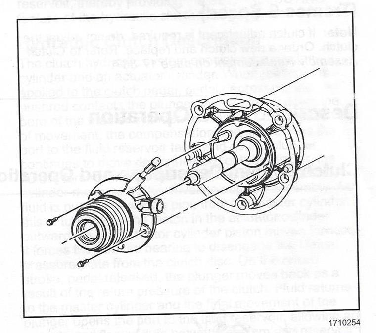

This is a pic of the C7 slave cylinder from the Service Manual, pretty small. My “guess” is the reservoir may hold 50% not 25% of the fluid so that 82.2% may be more like 90+%! My fluid looked like that or better after 8 empty/fill cycles! For the 2nd flush I stopped at 6 cycles!
C7 Clutch Slave Actuator.
