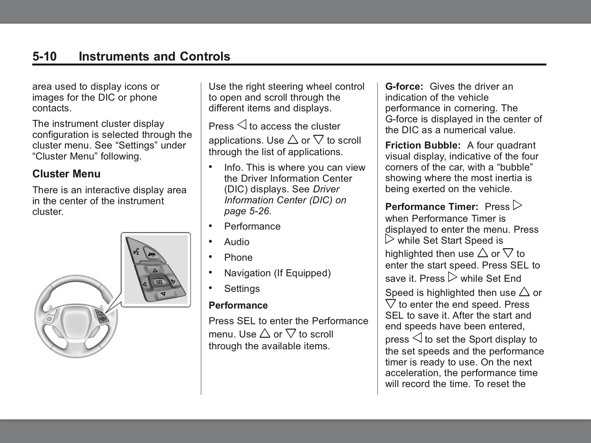

If you have the car on or in accessory, press the left arrow and that will bring up a menu that should have an icon of a phone highlighted. Scroll up or down with the arrows to change what's displayed in the DIC. These are your options and where you can find the info in the manual:

When I hit the left arrow I found that "phone" was highlighted. When I scrolled to "info" at the top and hit enter my problem went away. Thank you. The Forum comes through again.
