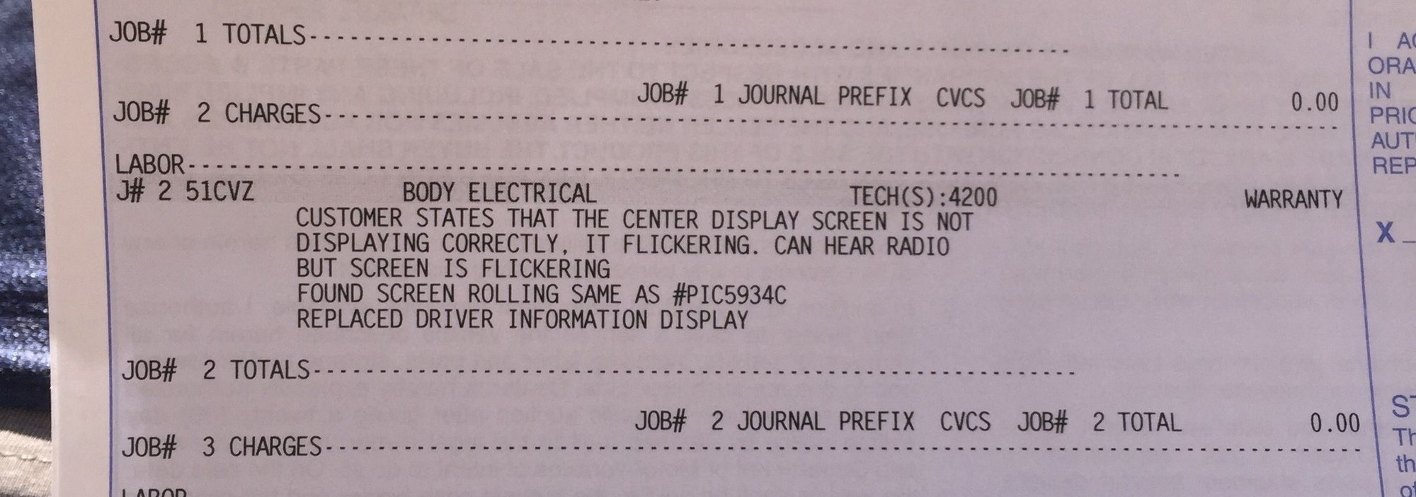

2014 M7 Convertible; 55K miles - The touch screen continues to occasionally flicker, roll, or black out, for no apparent reason. It is very intermittent - sometimes days between symptoms. So far, I have been ably to reset and restore it by opening and closing the access door.
Has GM found a cause and solution to this problem yet?

they will replace the screen....the base connector for the 14's was changed and improved.

Mine was replaced over a year ago. It took about an hour. 2014's have a 3 year warranty, but I guess you're over the mileage limit. That sucks!
